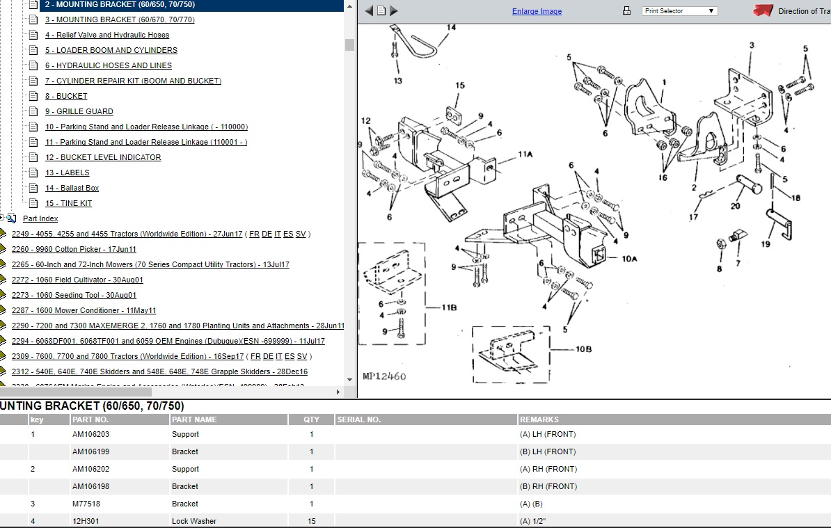

Just recently purchased a 1981 JD650 with an aftermarket loader. Last owner was using all kinds of bolt sizes/lengths. If someone has any information on the mid mounting bolts location/thread size/length, I would greatly appreciate it. It looks like there are two mounting bolts on each of the outsides and two on the underbelly. Thanks!

Maybe some pictures of what you are faced with would help with some answers.
Can find the loader brackets for the model 60 Deere loader that goes on the JD 650..
John Deere - Parts Catalog
:welcome: to TBN
