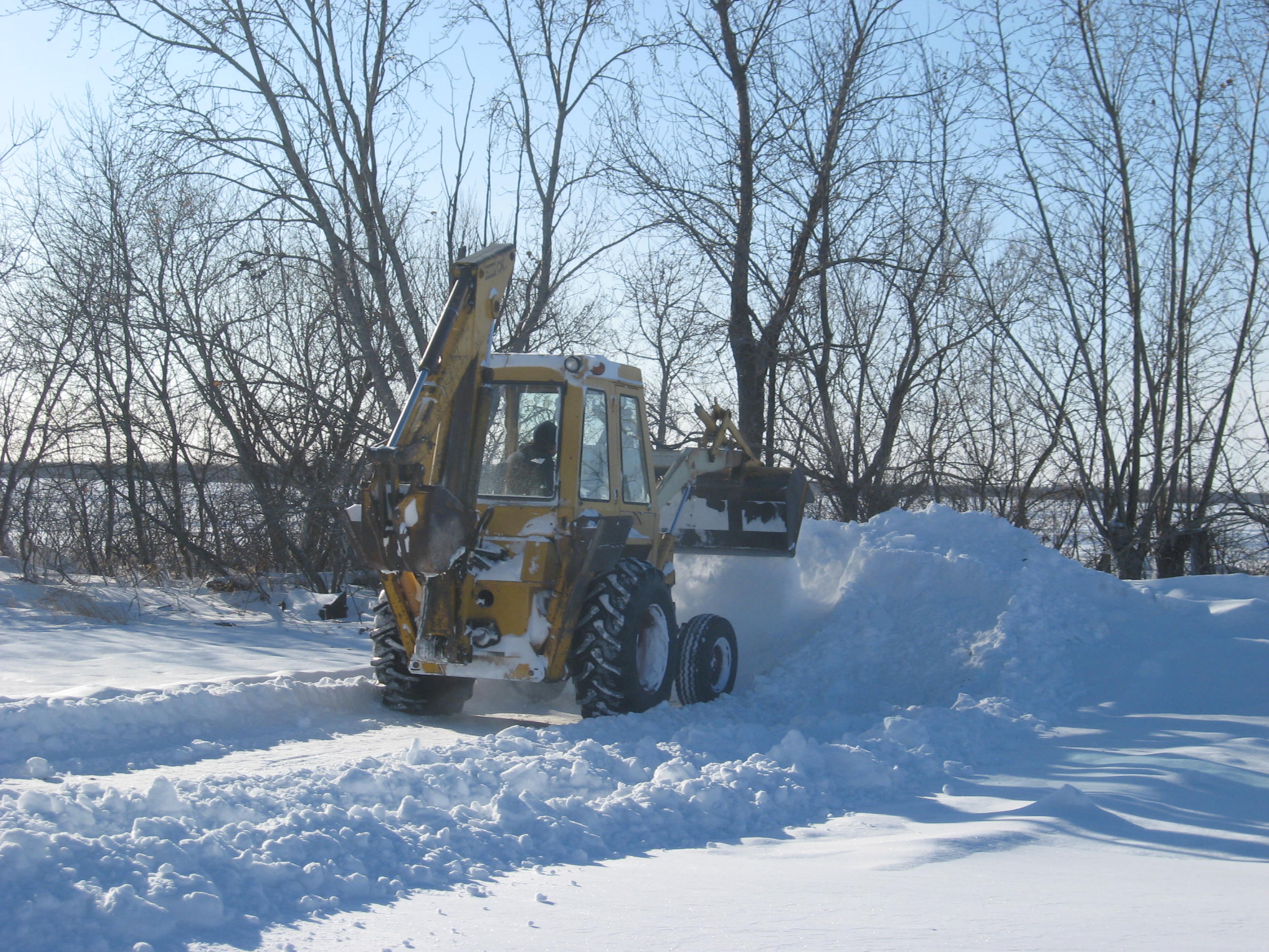

2 stick 580b Diesel cab running well sell for $7-8000 on auctions all the time . Have seen non-runners make $3000 . Impossible to value it without looking at it . Tyres are'nt that bad , I put one on my 580b last year for somewhere around $400 same size as our combine rears and front were about $160 .
