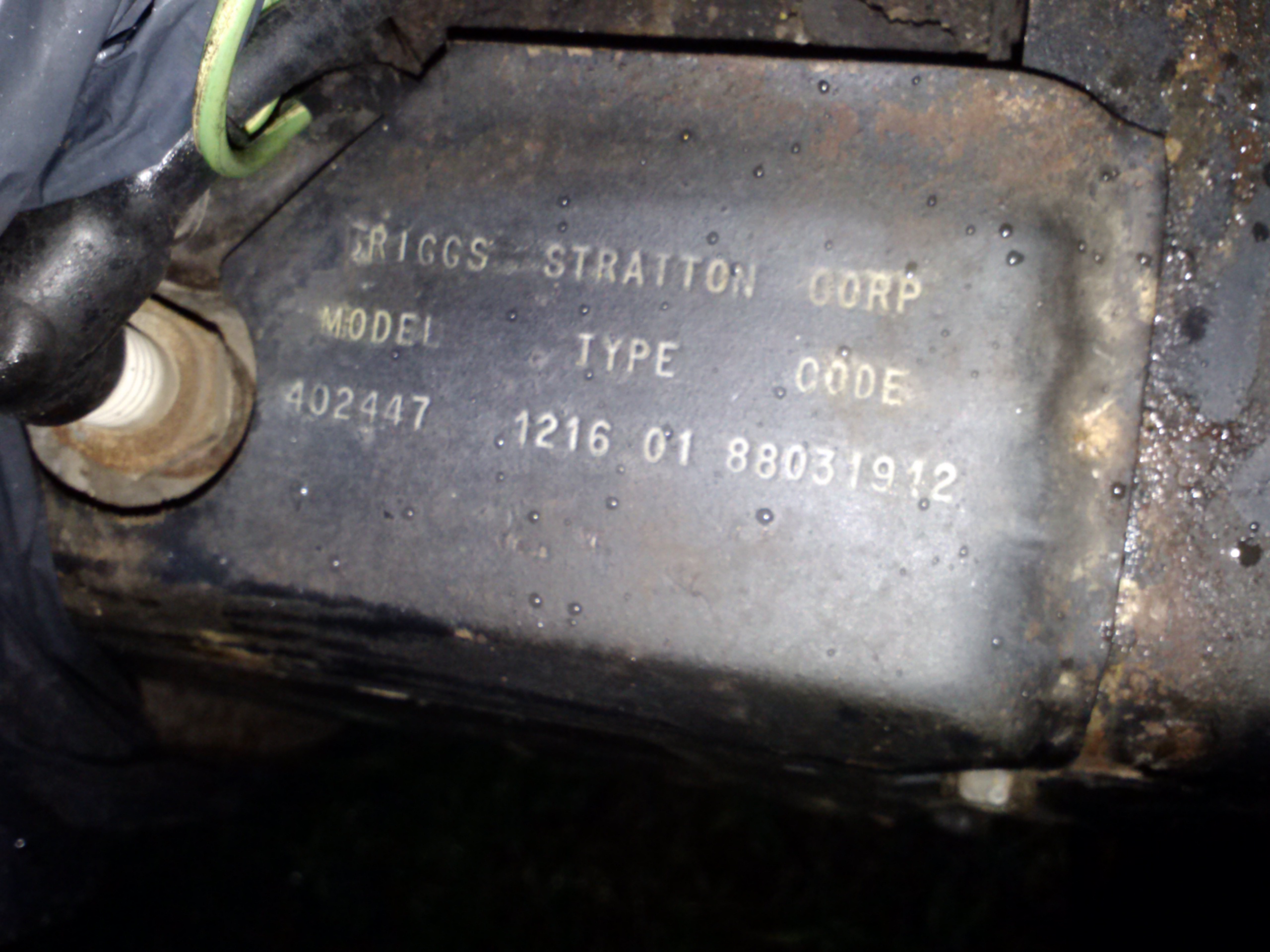

Hey I own a 1975 Sears ST16, With a 6 speed hi/lo trans. It originally came with a 16 hp Onan but that motor was seized up so swapped it out for a 16 hp Briggs and Stratton opposed twin cylinder engine. I have the motor mocked up on the frame but I have a ways to go. The motor runs as I have bench tested it and it came alive for a split second. However, in order for me to test run the motor I have to get the carburetor right. That is, I need to find the fuel inlet port on the carburetor. I believe a pump assembly bolts on the carburetor's side but it doesn't have it from what I seen in my research. I'll post pics of the carburetor and the whole project ASAP. But for now, here's the numbers of of the engine. 0922130334b.jpg If anyone has any questions or suggestions, they are more than welcome.
/ 1975 Sears ST16 Repower #2
Go to- superxpower.com and you can look up diagrams, the fuel pump is built into the carb.(if it has the correct carb)
