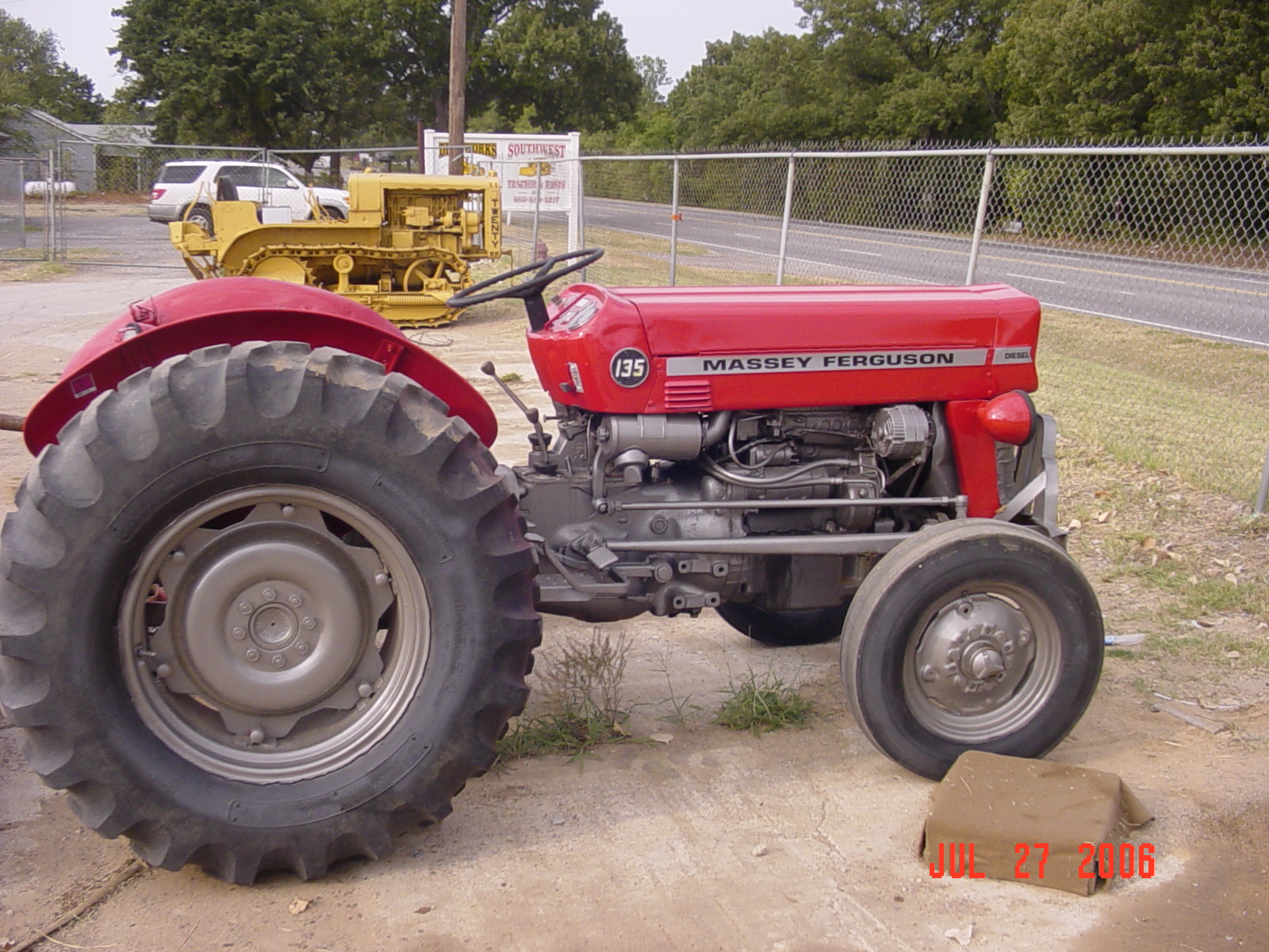

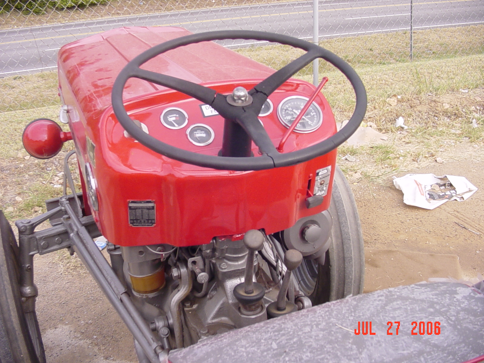

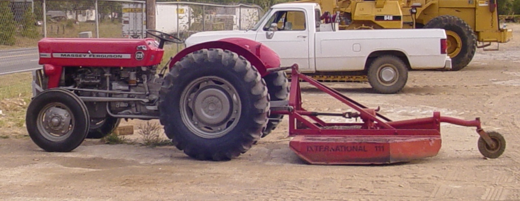

Thanks to all who replied for your helpful thoughts. The deal is done and I will pick up the tractor (with brushog) tomorrow! Several pictures are attached.

   / 1974 MF 135 - opinions solicited #8
Hey,
Nice Tractor!! Enjoy!!
   / 1974 MF 135 - opinions solicited #9
Congrats! That's a great looking tractor. I'm hoping to have the cash to look for a 135 one day. A couple of career farmers I know say that the 135 was the best tractor that MF ever built.
