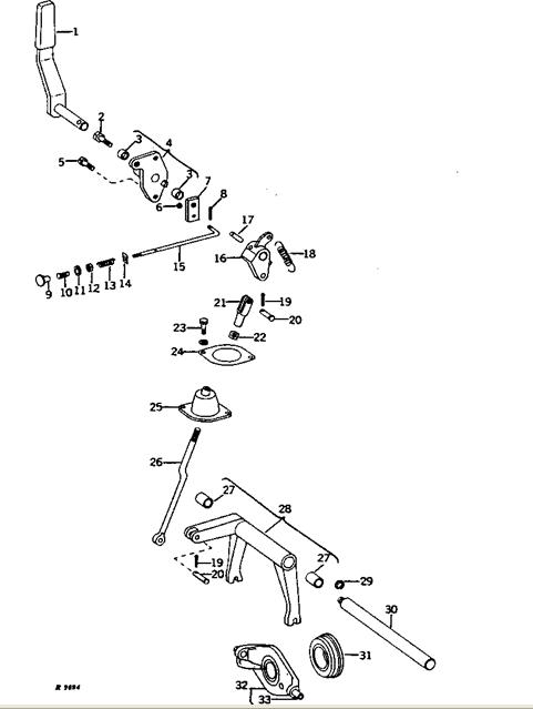

The knob on LH side of dash is a release for the catch on trans disconnect lever also on LH side outside of dash. This disconnect releases trans dampner(drive) clutch to aid starting in very cold weather. When released trans will not have power transferred to it. Back when I worked for a JD dealer I made several service calls on 4020's just to find out someone inadvertently had pulled disconnect lever back.
/ 1968 JD4020 Dash #4
Found it on jdparts. Thanks Jim, satisfied my curiosity.

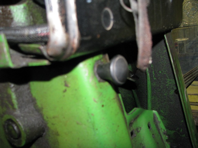

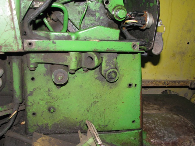

If you look at the post after yours Jim it shows a linkage and lever assembly. Ummm I dont seem to have that lever. There is however another assembly. I will take a couple of photos tonigth last night I was unloading the steel for my new 84 inch bucket I am building.
/ 1968 JD4020 Dash
Okay here is a photo of the knob nd the LH side of the console where I am guessing that lever should be.
Let me know what ya'll think

The hole farthest to the frt is the one that I think the handle should fit into.
One of the holes is the bracket part # R34743 BRACKET that bolts to side support is designed to attach the tube for a headlight when tractors were ordered less fenders. Is there any disconnect linkage under the dash?
/ 1968 JD4020 Dash #8
This knob only comes with the Powershift if anyone else is out looking in their shed. Just use the clutch pedal with a syncro
