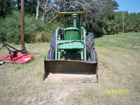

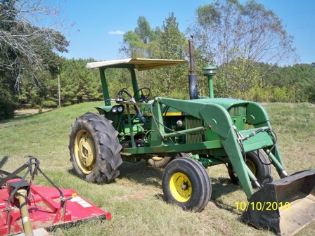

I bought a 1968 4020 a year ago and it has a loader on it. The numbers on the tag are "1010". Is this the right loader for this tractor? I noticed under the green paint there was yellow paint, but I do know JD used this color as a primer back then. I have attached a couple pics for review. I am trying to decide if I should replace this loader with the correct one or if this is a correct one.

Ok correction. The model number is 710 and the serial number is 3269. Sorry for the confusion, the plate was hard to read.
/ 1968 JD 4020 loader question #9
The JD 710 loader was an industrial loader designed for a JD 1010 tractor. You can view a photo of it on JDparts.com pc # 700. If it has the original ind hyd valve(part # AU11781U) then it's open center instead of the required closed center valve. If you disconnect return line with oil flowing into hyd valve and oil flows out return hose then it's an open center valve.

No. The 1010 was much smaller, the model before the 4020 was the 4010. The 1010 was less than 40 hp, the 4010-20 were up around 90 hp. The would expalin why the loader towers are so far forward on your tractor. To me it looks like they should be back closer to the operator. The only time I have seen that is when someone put a small loader on a larger tractor. That loader may look beefy due to it might have been for a 1010 industrial with a solid front axle. That would give it a greater capacity than a ag axle.

As a poster already stated the 1010 is a below 40 pto hp tractor and the 4020 was 94 pto hp.. Operating an open center hyd valve on a closed center system will rob main pump of output and severely heat the hyd oil/system which eventually shorten the life of the hyd system.

A 4020 is a closed center system as mentioned above, I would make sure that the loader valve is for a closed system. This could be changed while keeping the loader itself, I do not think I would spend the money to get a new loader.. fix what you have to work properly. My experience with 4020's and loaders is that the front axle is not as strong as the modern tractors which limits its capabilities. I can say that my smaller 110tlb does a better job with dirt and gravel work than my 4020 ever did. The 4020 was and is a great tractor in most other uses, sometimes wish I had one again.
