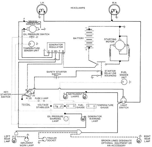

I am looking for a wiring diagram for a 1968 Ford 5000. Or wanting to know, there is a black wire coming from key switch to either the solenoid or the starter. I am not sure where it goes. And what screw does it go to? Tractor does not turn over when key switch is in and you press the start button.
/ 1968 Ford 5000 #2
5000 wasn't as popular as 3k and 4k so it might be easier finding diagrams for those and ignition would be wired the same. If you don't have some kind of general spec and repair manual,look at "IT Manuals" at Tractor Supply.
/ 1968 Ford 5000 #3
Try the Ford Forum at yesterdaystractors.com.
