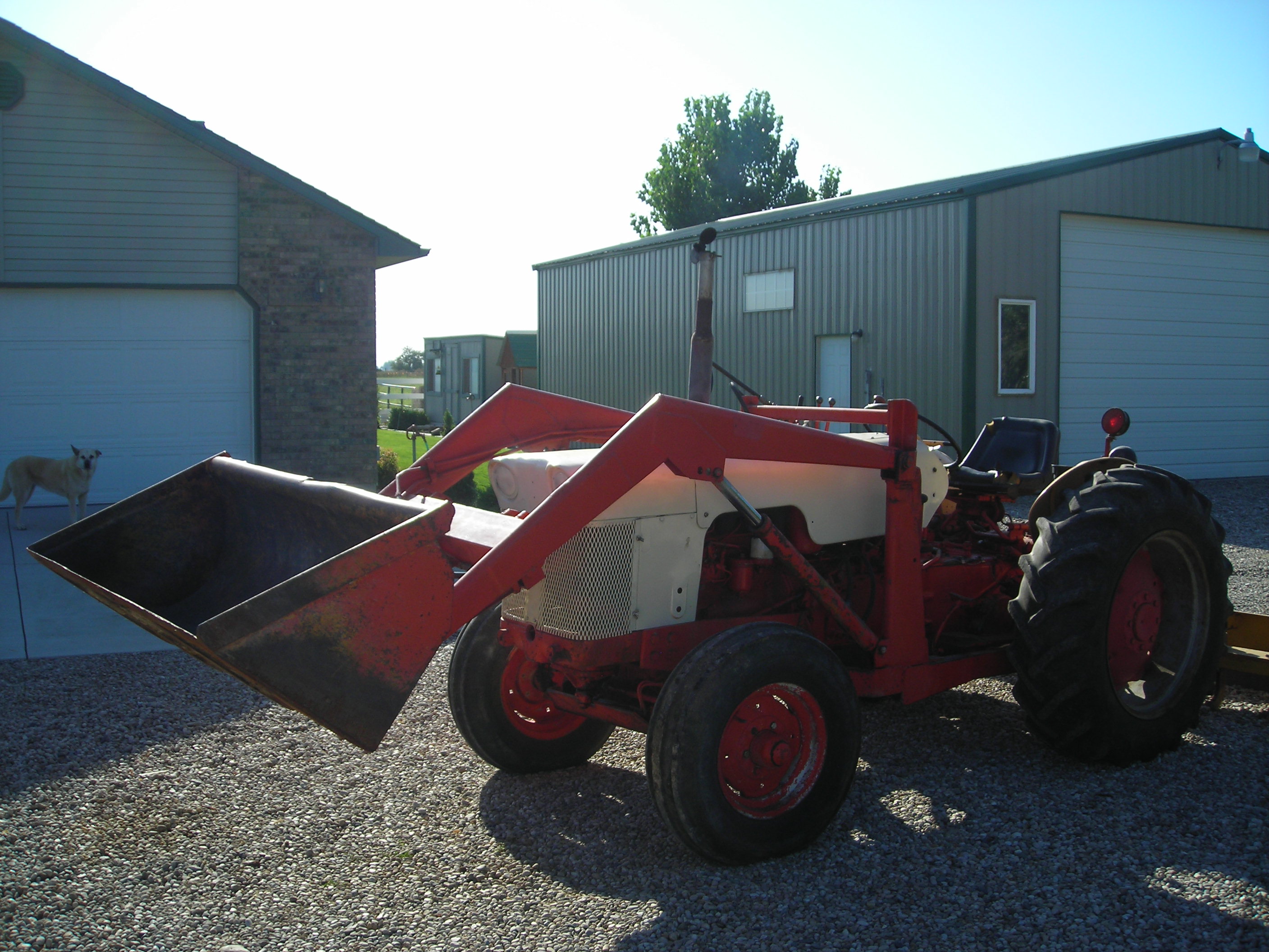

I have an old Case 430 diesel that needs:
Hydraulic pump pukes oil into tranny
Leaks gear oil around rear PTO
Brakes
Tires
Power steering hard as hades in one direction
Tie rods
Other than that it starts, runs, and drives like new.
What are these worth and are they worth fixings up?
Are the parts hard to get?
/ 1964 Case 430 #2
It's not your pump's fault that oil moves between the two tube halves. The steering problem is in the steering cylinder valve unit. You virtually can't get parts for for the steering. Oil can feed back through seals and o-rings but the the two tubes use the same oil supply. Use your book and take off the parts where the pto leaks and replace the gaskets and seals. Case still sells most gaskets. As far as what it's worth, it depends on who wants it. I'd buy it for parts.
