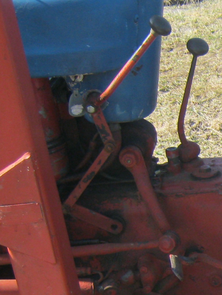

Thanks for all the help so far. Here's the latest:
I jacked up the rear end. With the transmission in neutral, I spun a tire by hand and the other tire spun in the opposite direction. With the rear end in the air (insert your own joke here...) I started it up, and went through the gears. Strangely, the wheels turned in the opposite direction - it was like I had 1 forward and 4 reverse. The PTO turned when the clutch was engaged. Lowered it off the jack, and went through the gears again. It didn't take off, but I could see and feel a slight movement of the wheels in each gear - but again, it was in the opposite direction! Am I missing something?

It sure sounds like the clutch. Sound guy would know about this better than me, but there was an auxiliery transmission option available on those tractors that could provide a step up and down (so 12 gears forward and 3 reverse). I have this option on one of my tractors. I am pretty sure Sherman transmissions also came in a reverser option, instead of the step up step down. Is it possible that you have one of these and it is stuck in reverse?
During these tests, did you check the PTO with the tires on the ground and the tractor in gear?

diffy action is normal for one tire to spin fore and the other aft.
if you get pto and tire movement under no laod, but none under load, clutch may be at the end of it's life

I didn't think anything of it at the time, but when I was testing it today, I seem to remember that the PTO shaft turned counterclockwise. Now tonight I've seen a few discussions that indicate the PTO shaft should turn clockwise. True?
/ 1961 Ford 4030 - Clutch Problem? #36
DID YOU TEST THE PTO WITH THE TIRES ON THE GROUND AND THE TRACTOR IN GEAR???
I think you may have an Auxiliary Reverser Trasmission. It is a seperate trasmission that could be later added on. It would be located in your bellhousing with its own shift lever coming out the side. A reverser trasmission WOULD reverse the PTO direction when in reverse.
Just to be clear, if you have a reverser aux. trans., and it is in reverse, you would go forward if your main trasmission was in reverse (but the pto would still spin backwards)

yep.. pics and bellhousing numbers are needed.
ps.. many of those aux trannies have a neutral position too!

I think you're right - I have attached a photo. Is this the reverser?
