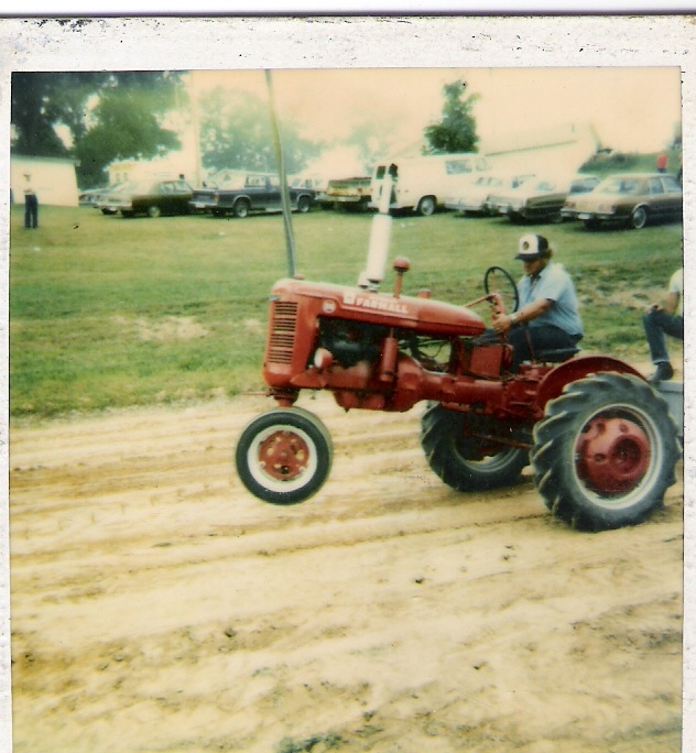

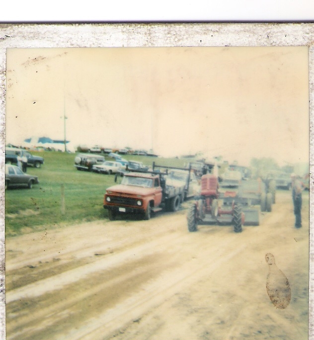

On the other hand, posted below is a couple of pics of me on my Farmall BN many moons ago... 3,000 lb. class, and I weighed in at 2995 lbs. Max. drawbar height, and ballast in the seat where you need it, LOL... Steered it by leaning, like the garden tractor pullers. Of course, this was a tug pull, not transfer sled. She came off the line like that,and a full pull is only 20 ft. But I won the class..!! And probably one of the reason they now require the front wheels to stay on the track, or fasrly close anyway... But, what kind of fun is that..?? New Image.JPGBN%20Walking%20Tall%20Barlow%20Fairgrounds[1].JPG
