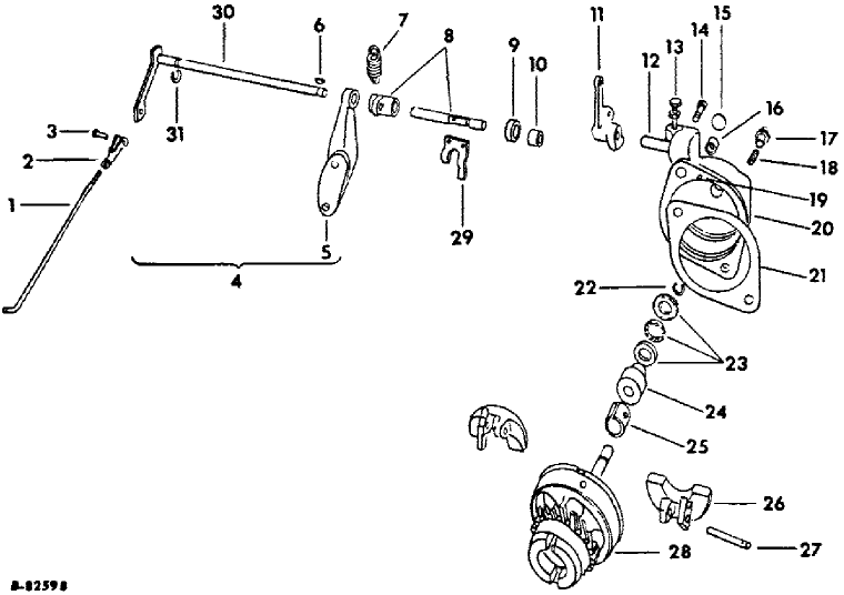

I'm having trouble. My engine cranks but I can't idle up the throttle lever is hard. What can my problem be
/ 1952 farmall cub #2
First - Check your linkage that runs from the throttle.
Can you get it to start? When did it last run? Also lube all the pivot points to help smooth things out a bit.
/ 1952 farmall cub #3
Slip the pin out of the governor arm, and see if the rest of the linkage is free moving, from there back to the carb. If it is, it may possibly be the governor return spring (#7) is broken, or possibly thrust bearing (#23) behind the governor weight carrier assembly, has come apart, partilly disentagrated. (See and enlarge exploded view of gov. assy. below)
Semi-common wear items I keep in the shop. Although I was shocked at the now prices. Through IH, the spring is $9.30, and the bearing is right at $30.00.
I bought 4 ea. back in the 80's to keep on hand, as they were that cheap. Springs were less than $2.00, and seems like the bearing was around $4.00.
It may not be your problem, but on several of mine, when they will not throttle up past about 1/3, that is generarlly the problem.
If you do find this is the problem, be sure to look for the broken, or loose pieces. The ball bearings usually go to the oil pan, but...
