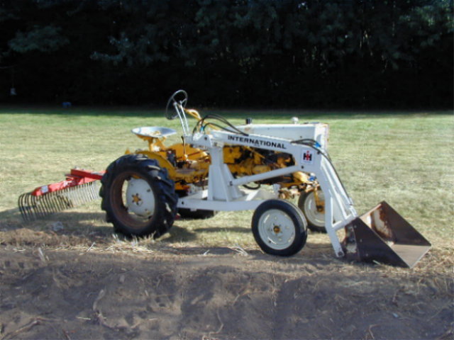

Loader type? Hose routing? Using a diverter block or blocking the rockshaft?
I just sold an IH 1000 one arm loader which I restored and had mounted on my '66 IH Cub. See attached pic...Is that what you're talking about??? Chuck
