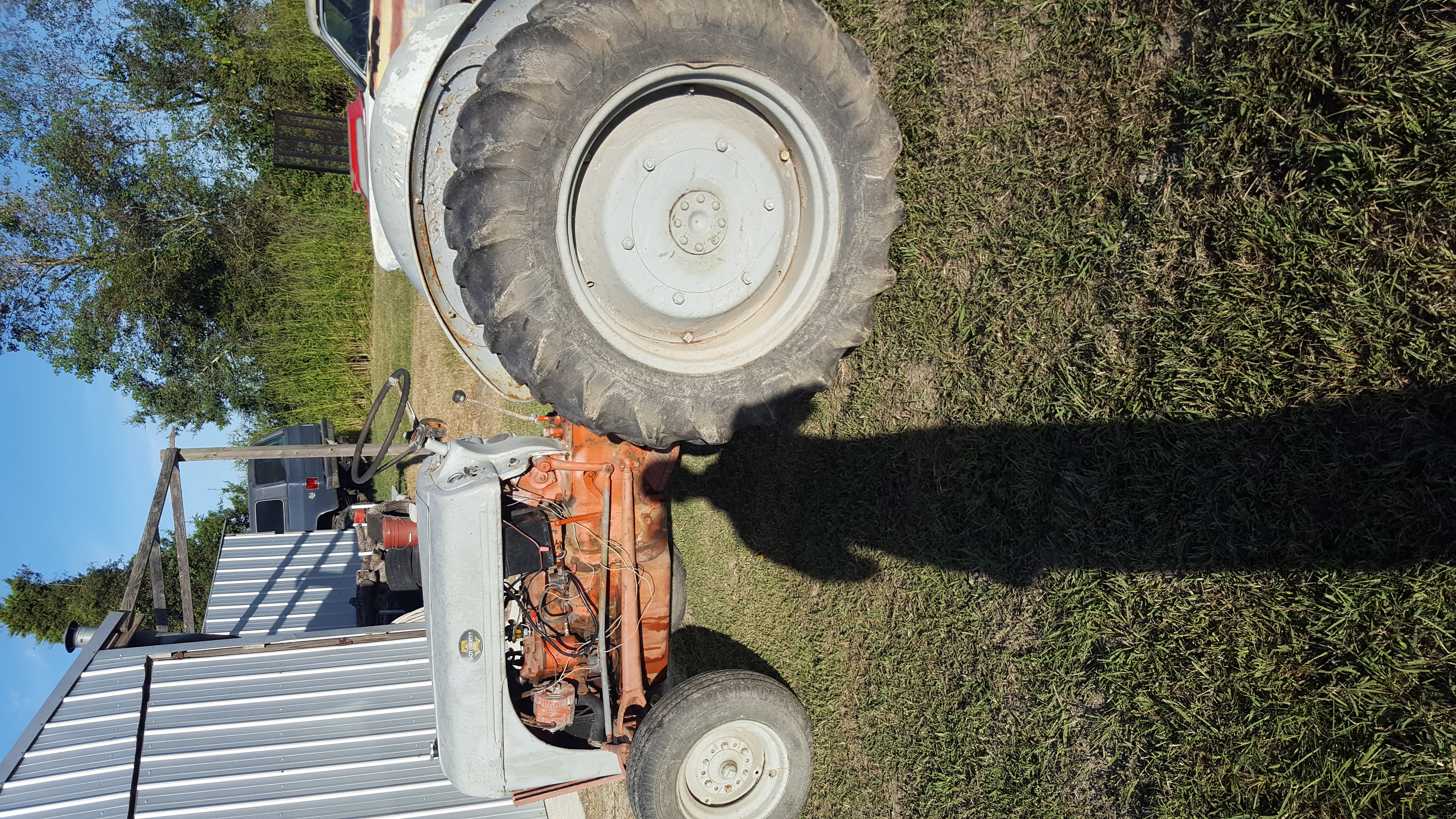

I'm looking for a little help guys.
I picked up a ford 8n and after doing a little research on the web it looks like my 8n has 9n rear wheels, is this possible
I checked all the numbers and so for all match up to 1950.
I haven't located the numbers on the rear housing yet,any idea where it may be located.

It won't have 9N rear wheels without having 9N rear axles. Picture?
Edit: your pics were posted at the same time as this post.
They are 9N/2N axles and wheels.

Looks like there are a few other parts that are not original as well:D

yes mapper you are correct on that, front wheels are also wrong, as well as the home made drag link or tie rods

The steering tie rod looks bent. On the plus side I think it has a Sherman auxiliary transmission. I would guess that some prior owner had several old Ford's with broken bits so the good bits made one tractor....

You can have 9n wheels/axle bolted on to an 8n center housing. If the center housing doesn't have 4 holes underneath toward the rear than it's a 9n
2n housing. Tires have some cracking but ain't no big deal. If it ain't going to be a show tractor run them as is. Agree, change out that rinky dink steering wheel. Sherman is a combo. In has 3 ranges and will give you 12 speeds and 3 pto speeds.

Look to me like they either changed out the trumpets, with or without the center housing. If it's an 8n center housing it will have 4 bolt holes underneath for drawbar and looking at the rear of your toplink there will be ears on each side which may or maynot have a long pin installed. It also looks like you might have a lever on the round cover which could be a howard trans. If so with the howard in low range and the sherman in low range you can walk on you hands and still be faster than the tractor. Here's a shot of my wife planting potatoes. Tractor is running/driving when I step of to take a couple of photos.
