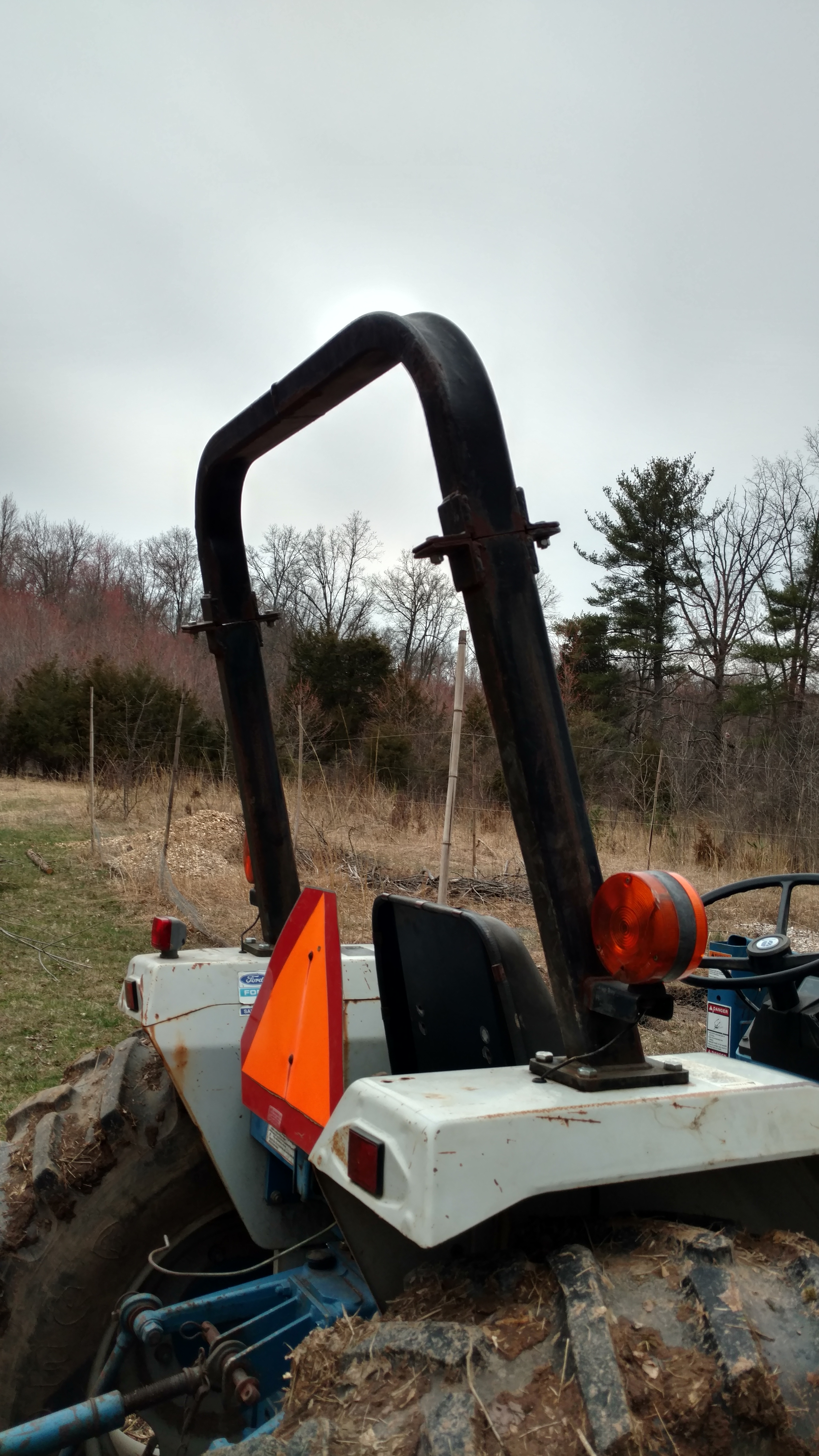

I had asked questions about the modification of the ROPS and if the crack can be repaired, but I answered my own question.... I'll be replacing it.

I have never seen rops mounted on the fenders. Can`t be that strong.
   / 1920 ROPS Questions - Is mine modified? / Can it be repaired?
Its mounted to the axle - the fender is mounted to the axle as well, through the rops mount.

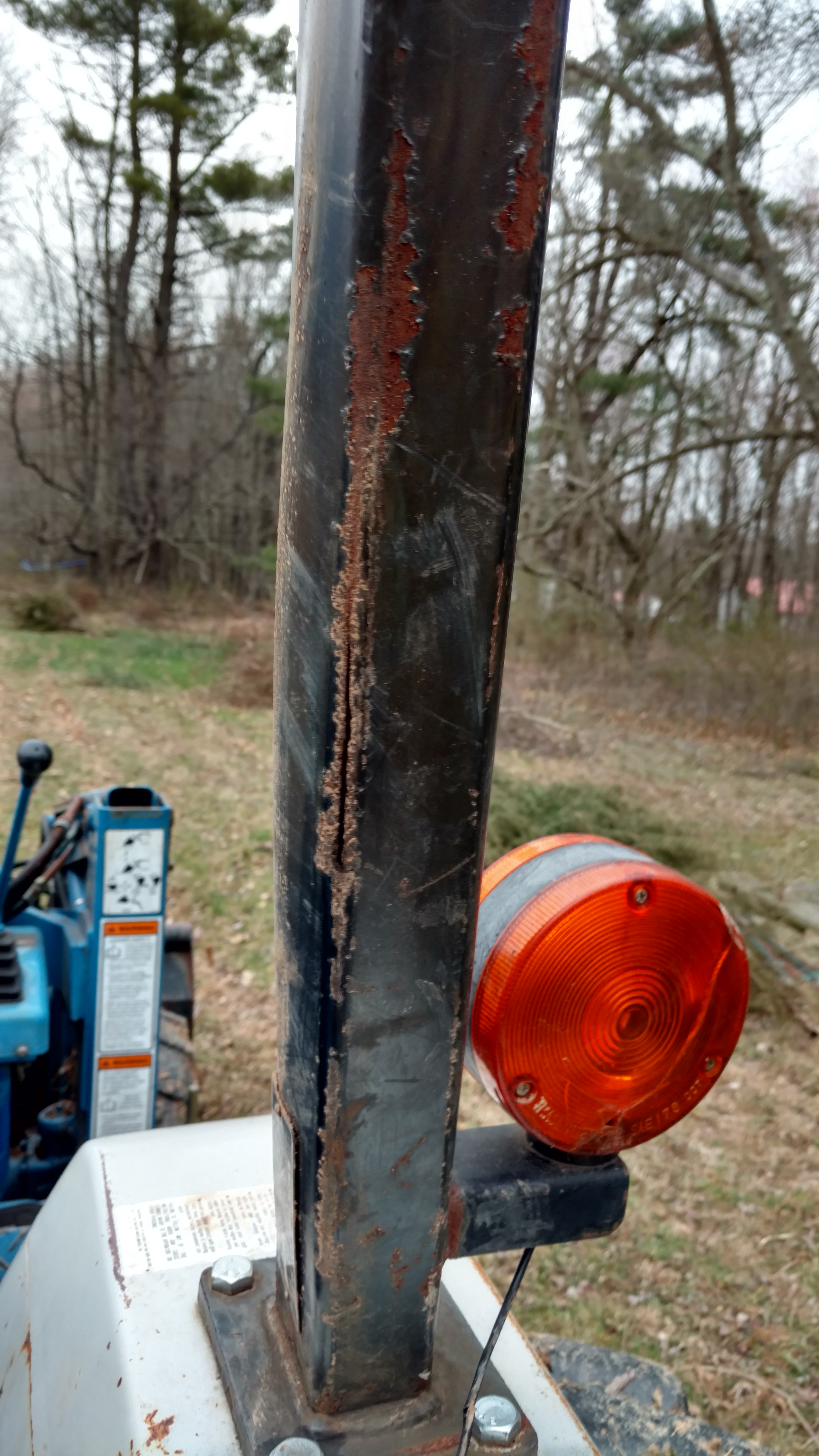

It's the split in the rops that is the mod.
   / 1920 ROPS Questions - Is mine modified? / Can it be repaired? #4
The ROPS mount as shown is normal for a 1920.
Those SPLITS in the ROPS are nasty! (looks like new mounting bolts though)
A ROPS replacement is definitely required!
Dunno. But that buldging isn't normal? Standard is straight?
   / 1920 ROPS Questions - Is mine modified? / Can it be repaired? #8
It will be cheaper for someone to make one for you. Most junk yards will not sell the ROPS. I would replace that one.
