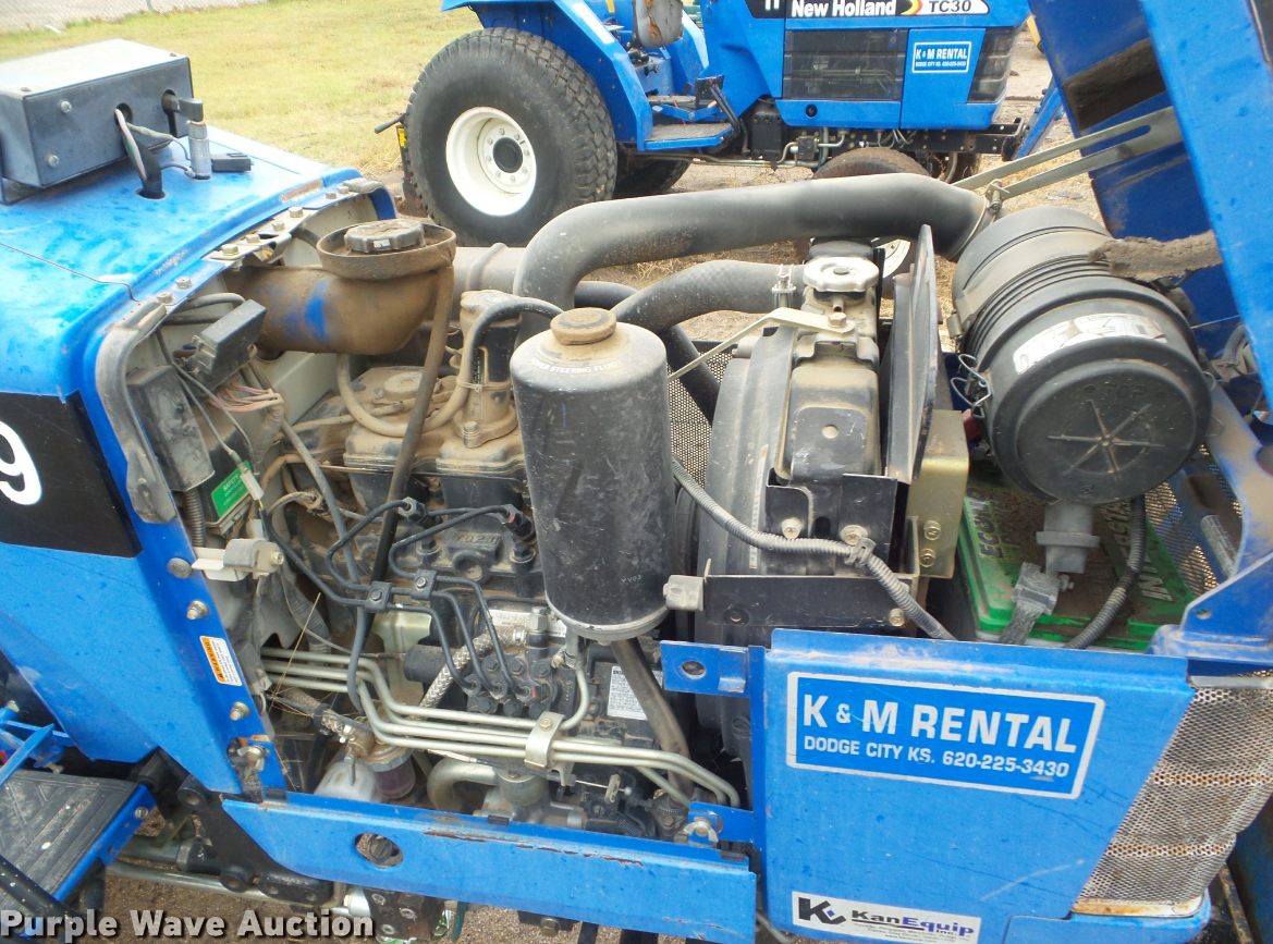

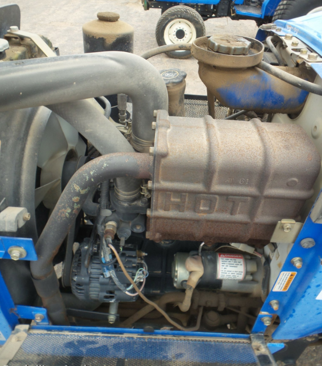

If you could find a breaker that would sell you the parts from a TC30 at a reasonable cost. Looks to be the same layout as the 1520,1620,1720 tractors. Not sure about the 1920. I think that is a larger beast. Could tuck the exhaust under the hood. Looks like the main thing they moved is the air cleaner.
From ur pics it’s looks like a long shot but I may just call a dealer and see if they have any ideas. Clearly, porting it down like on the TCs has advantages including thee off chance disaster when the muffler cap accidentally gets stuck in the up position and it rains. Never happened but did have an ice storm lock it shut once and was very befuddled re why it wouldn’t start until I checked it. Whole tractor was encased in 1/8” ice. Always something…
