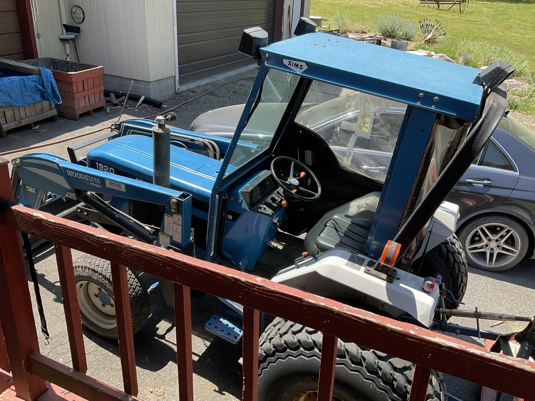

If you could find a breaker that would sell you the parts from a TC30 at a reasonable cost. Looks to be the same layout as the 1520,1620,1720 tractors. Not sure about the 1920. I think that is a larger beast. Could tuck the exhaust under the hood. Looks like the main thing they moved is the air cleaner.
From ur pics it’s looks like a long shot but I may just call a dealer and see if they have any ideas. Clearly, porting it down like on the TCs has advantages including thee off chance disaster when the muffler cap accidentally gets stuck in the up position and it rains. Never happened but did have an ice storm lock it shut once and was very befuddled re why it wouldn’t start until I checked it. Whole tractor was encased in 1/8” ice. Always something…

My former 1920 came with an exhaust extension above the muffler, maybe 10" long. Its tip curved to shoot the exhaust almost horizontally instead of straight up and it was rotated to shoot it forward. I might have a leftover extension around here from when I replaced the muffler.
That exhaust stack was a pain when mowing around all the trees so I asked the dealer to mount it horizontally. After he waded into it, he said he couldn't make it work. Might have interfered with the loader or something else.
I never thought much about the noise until I replaced it with a Kubota. It wasn't as loud inside the barn.
   / 1920 is SO LOUD…why? #19
Here's the extension I mentioned, on someone else's tractor:
