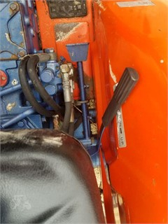

This is a picture of a LB1914 with a loader. The hoses go to this diverter valve. It is similar to my LK2554. You just can make out the knob in this picture but you rotate it when you have a loader installed then it will send the fluid to the loader valve first. This is block I was asking if you could take a picture of.

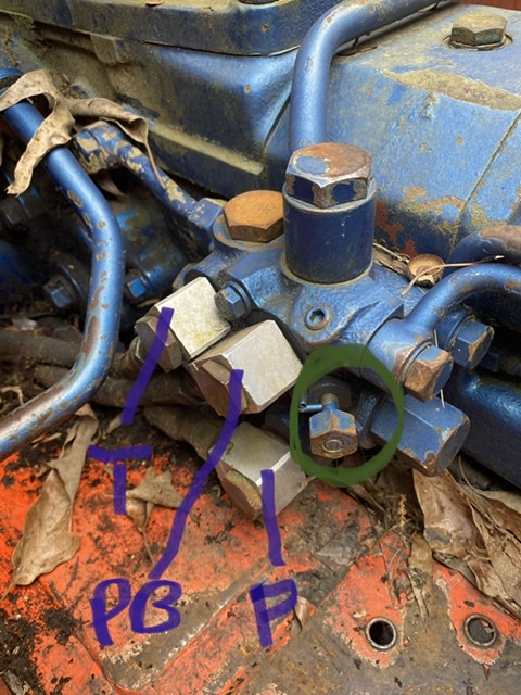

I don't quite understand where the loader hoses/lines go. I see that I'm looking down on the valve and looks to be 4 lines attached. There appears to be 2 hex head plugs between the existing lines so, is that where the loader lines go?
/ 1914 front loader #6
Yes that is the hoses for the loader valve. Sorry I should have been clearer. Here is a picture of mine that shows the knob you turn after running the hoses. I marked the hoses and circled the valve in green.
P is power that feeds the loader valve.
T is the return to tank from the loader valve.
PB is the power beyond line from the loader valve. This one is what feeds the 3pt hitch valve.
