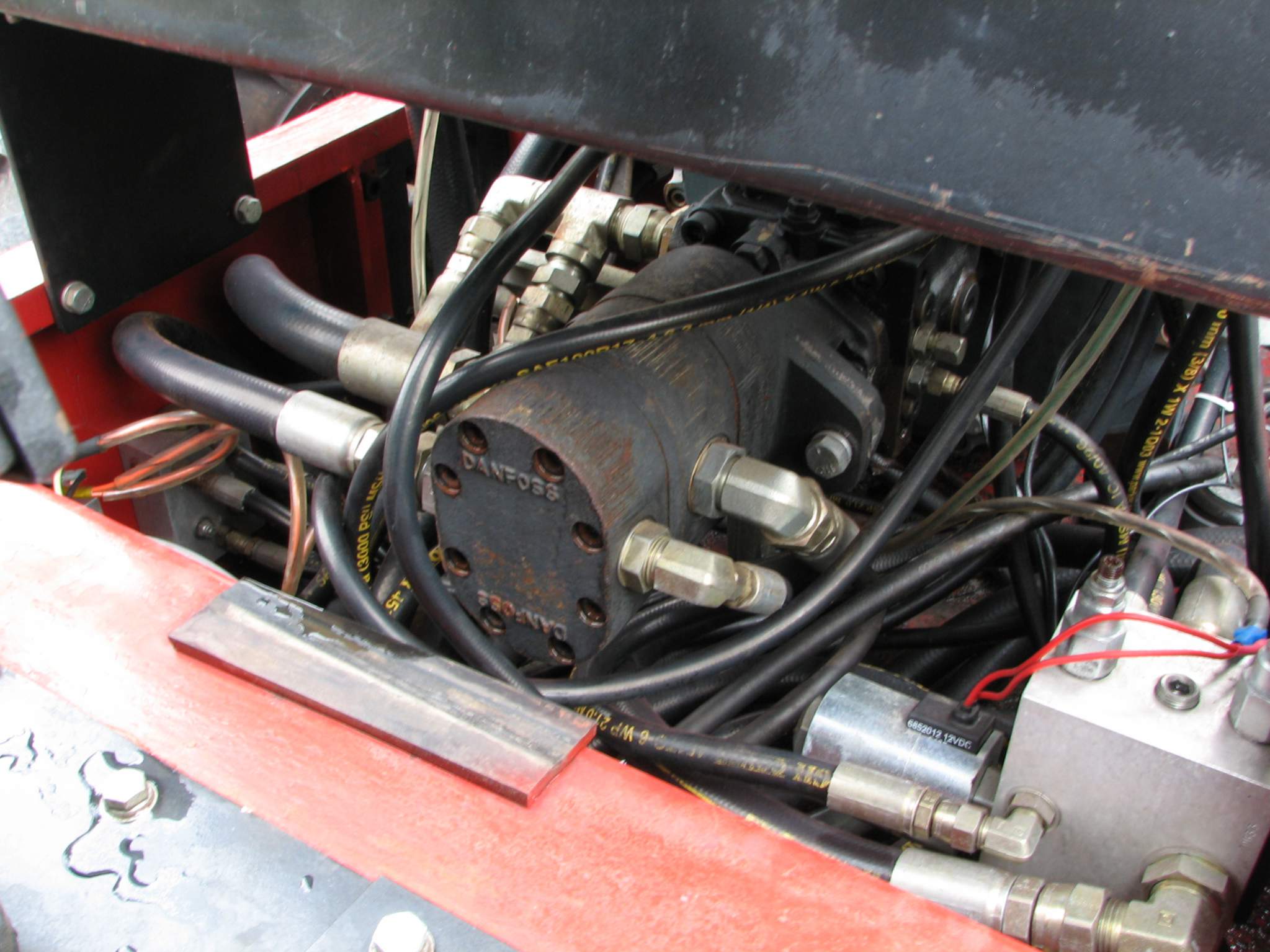

I have been trying to figure out how to do it in 3 ways.. Cheap, Ergonomic, Convenient, and not confusing. Saddly, like any job, One of the three needs to be compromised.
I am thinking about tying into the seat hydraulics. Haven't figured out the control system yet. Sort of have a design for the 3pt hitch. Will call Taswell to see if they have pix of their old design.

If I were doing this, I would Tee with priority to steering and use an electric solenoid valve perhaps with flow restrictors at the cylinders. It is much easier to run a few wires through the tunnel versus hoses. Our tunnels are pretty packed although i was able to run a large ground and some power wires through it. Even used a piece of hose to protect them and to be used as a future path for any additional wires.
If desired, you could even make the electric setup 3-way so you could control the hydraulics from the back of the tractor as well. An example would be if you were using a log splitter run by the PT.
Carl, just a thought but if you want this just for running cylinders, get a used 12V hydraulic pump setup taken off of a truck lift. Go for pretty cheap $. Then use 12V switch to turn the pump on and a switch for up or down. Ideally valves would hold the cylinders in place and you use the pump to power it up or down with the appropriate end of the cylinder being vented back to the tank. Even cheaper is pump to raise, then vent and let the weight lower it. But that is not great for pushing steel into the ground.

Or just run one pressure hose through the trunk and some electric lines for any additional circuits besides the first cylinder. Then run a line from them back to the tank. But for just controlling a couple of cylinders, I still like the idea of installing a used 12V pump from a truck lift gate. I paid $50 for one. Or installing a priority valve at the pump, giving priority to the steering. I think I like that idea even better than the 12v pump.
There is much more room to mount things in the rear tub and you do not have to pay for all of that hose either.

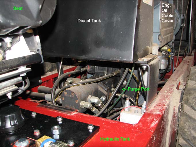

I don't know where you would tap off a pressure hose from the front.
On mine the pressure hose comes from the pump.
Pump to steering valve.
Steering valve power beyond port to joystick/aux PTO valve.
Joystick/aux PTO valve low pressure back to the tank.
If the joystick/aux PTO valve has a power beyond port, you could tap off of that to feed the rear circuits.
If not, I don't know where you would tap it.

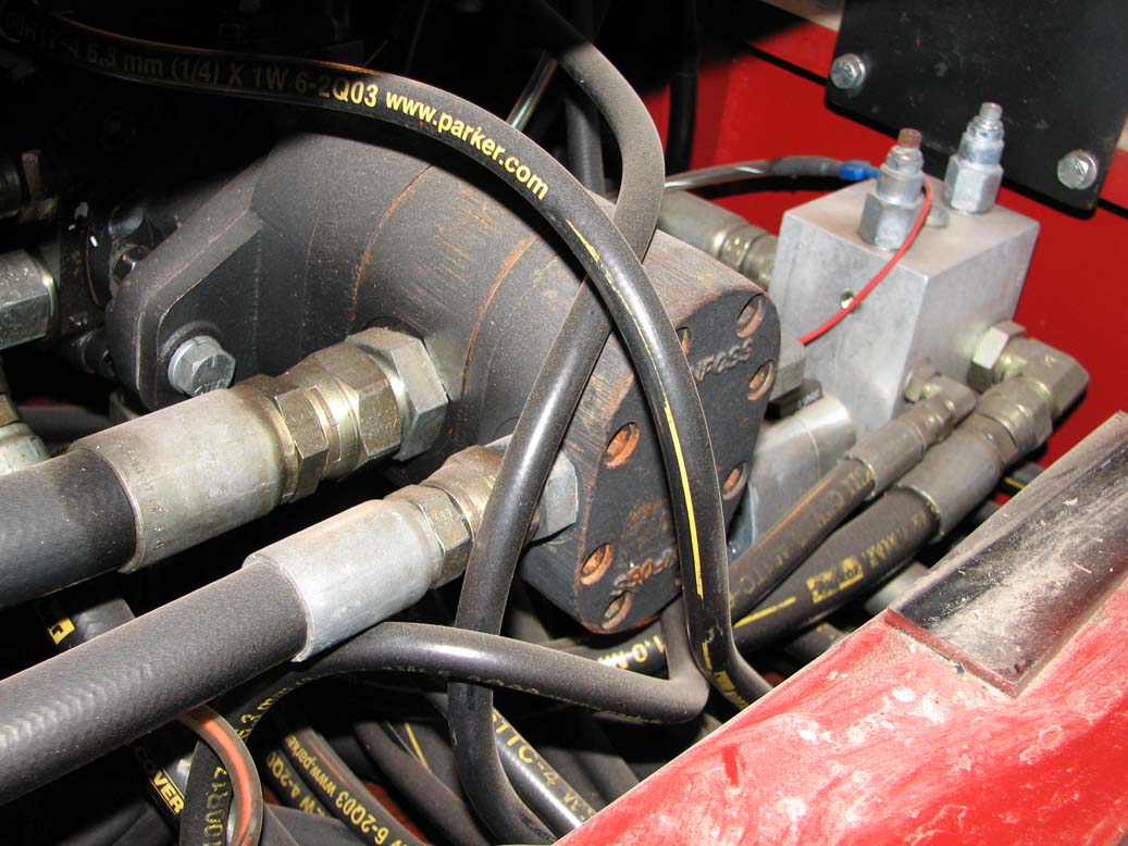

If going that route, he could add the additional circuits like I did mine using selector valves to select the new circuit or the existing tilt etc circuits. Then he could still use his existing joystick for controlling both.
http://www.tractorbynet.com/forums/power-trac/221220-added-additional-hydraulic-circuits-pt1850.html
Ken
That's what I was thinking, too, but it would require running multiple hoses to the rear and there's apparently a premium on space in the tunnel.
