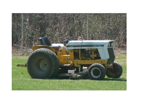

I'll try a picture, not actual tractor but same model.
