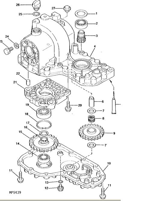

Does this look like your tranny case?

I am pretty sure that this is what the tranny looks like the one on this link:
John Deere - Parts Catalog
If there is a filter, I'm not sure where to find it? As of now, the mower has very little power forward and a bit more in reverse, but still cant climb even a very slight incline.
