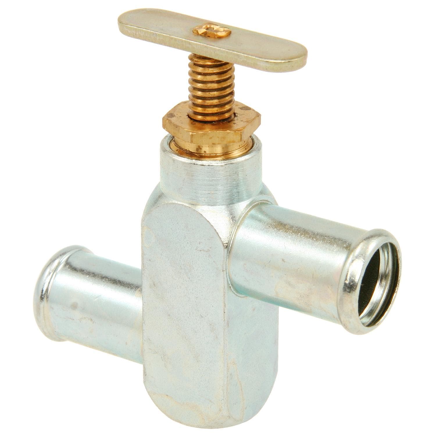

You're right, a suspect heater valve is indeed a well known culprit in certain A/C problems. It comes up more often than people would think.
It's your choice of course, you can go looking for it in the cab, (whatever that takes) or do what I do. Look for a spot on one of the hoses where it's easy to reach, cut the hose and install one of these. (or something similar) Leave it closed until winter.
/ 1754 AC

Again, it's your tractor, your money, your choice. If you wish to "keep it all factory' then by all means, go for it. Most in cab valves any more are all plastic and prone to failure sooner of later. If not the valve, the cables that operate them. I've installed dozens of this type valves on many different tractors over the years and have yet to get any complaints about the aesthetics. Most people are just happy to have the A/C working.
