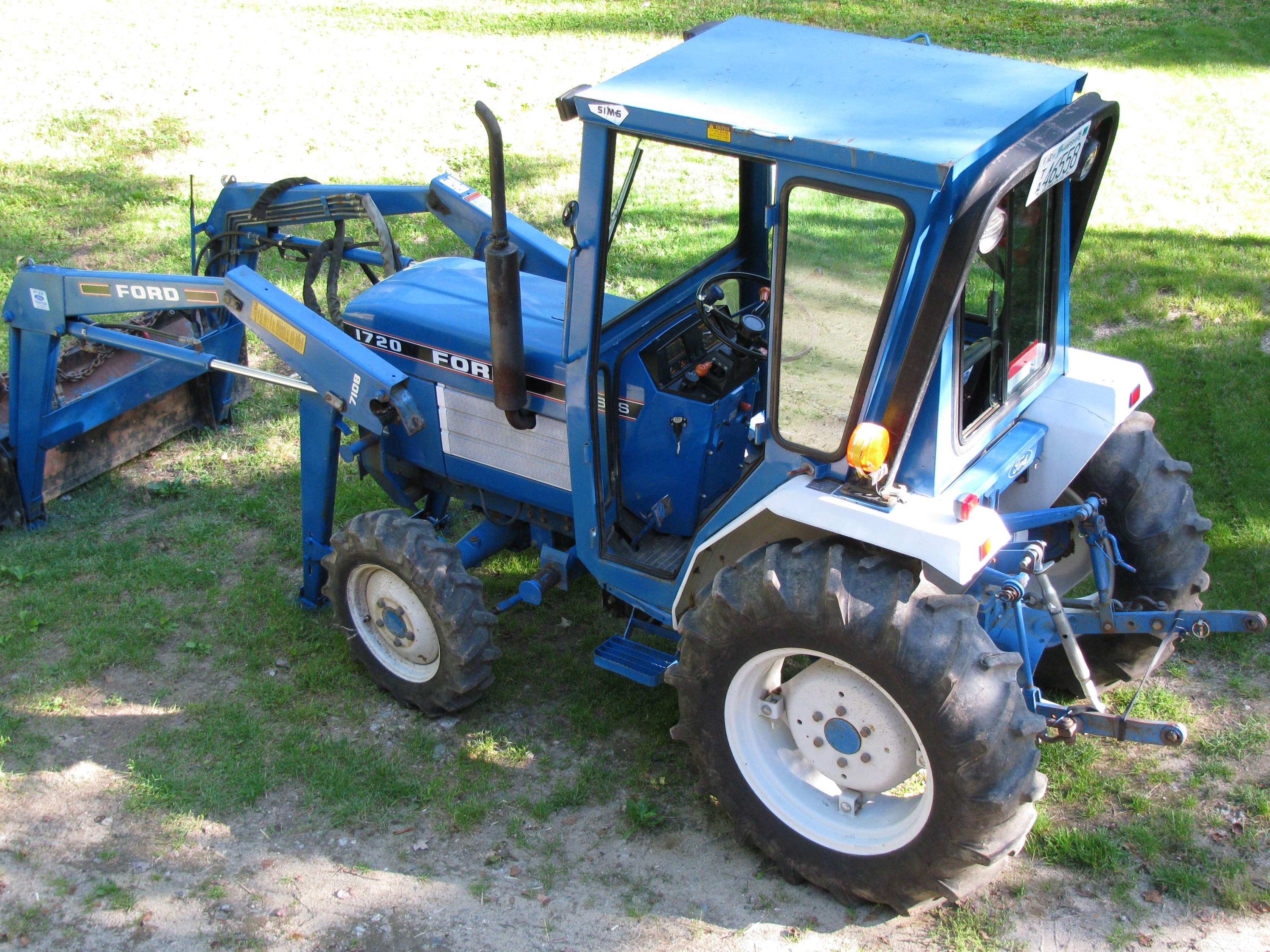

OK guys...
Happy ending to my pto clutch delema. Had a mechanic over to help with a few things. I am getting a sub frame backhoe and had questions about the hydro attachment. Thats another story...
My PTO clutch works fine now. He watched the clutch pedal as I moved it and determined a foot step bracket that was bent cheated the pedal from bottoming out. He preyed the bent bracket and presto! My PTO will shift while the tractor is running.
DUH! For a moment I felt stupid. Then I said "It's a miracle!"
I asked him how much I owed him and he said "Six hundred bucks, miracles cost extra!"
Ha Ha LOL...
I was so **** happy I spent all day working on her. I did the usual Oil, Filter & grease(10 hours over schedule), fuel filter, cleaned the air filter, a general clean up. Took the control panel off and found a HUGE nest. Vacuumed that out with shop vac. Part of the wiring harness to the gauge cluster was chewed through. I taped that back up to original and lubed the shifting linkages.
Overall she looks ok for 19 years old!
Thanks everyone for your input with this.
Mark

Lots of expertise out there on the 1720 and much appreciated.
Thanks JC Jetro for your earlier advice to me on my cracked head woes on my 1710.
I have PTO woes on my 1720
The outer shaft spins no matter whether the engine is running or not and no matter what the setting of the operating lever.
I notice mention of an electricsl override switch. Am I negecting some simple step in making the shaft turn?
This tractor has only been used onroad as a shopping centre trolley retieval tow machine, so I doubt whether the PTO has ever been activated in the life of the machine.
Any advice appreciated. I don't like the sound of the tractor split. Sounds easier to wreck the thing and buy another tractor
