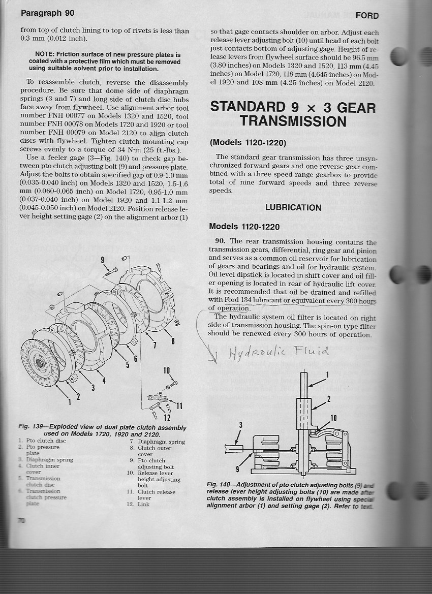

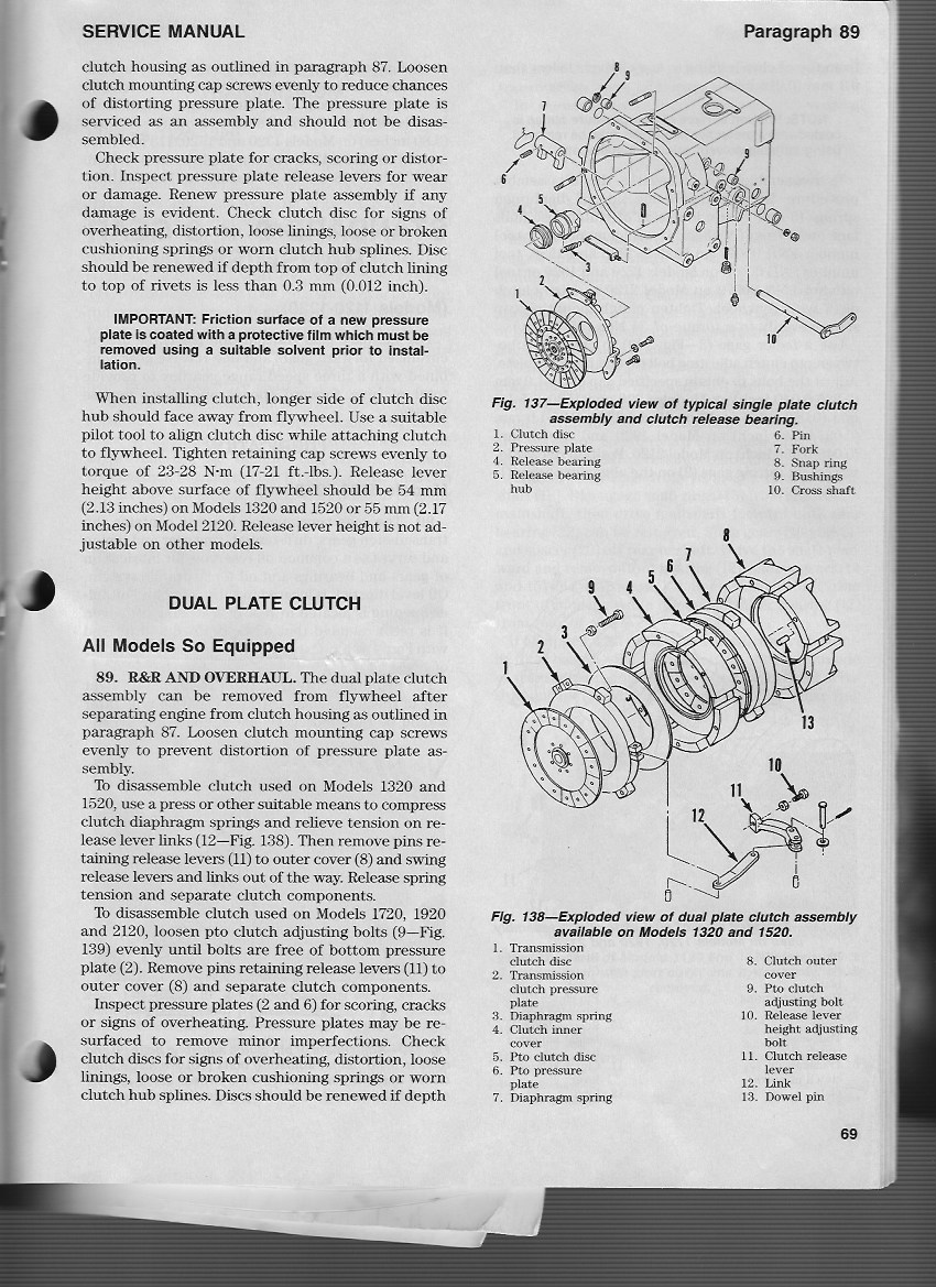

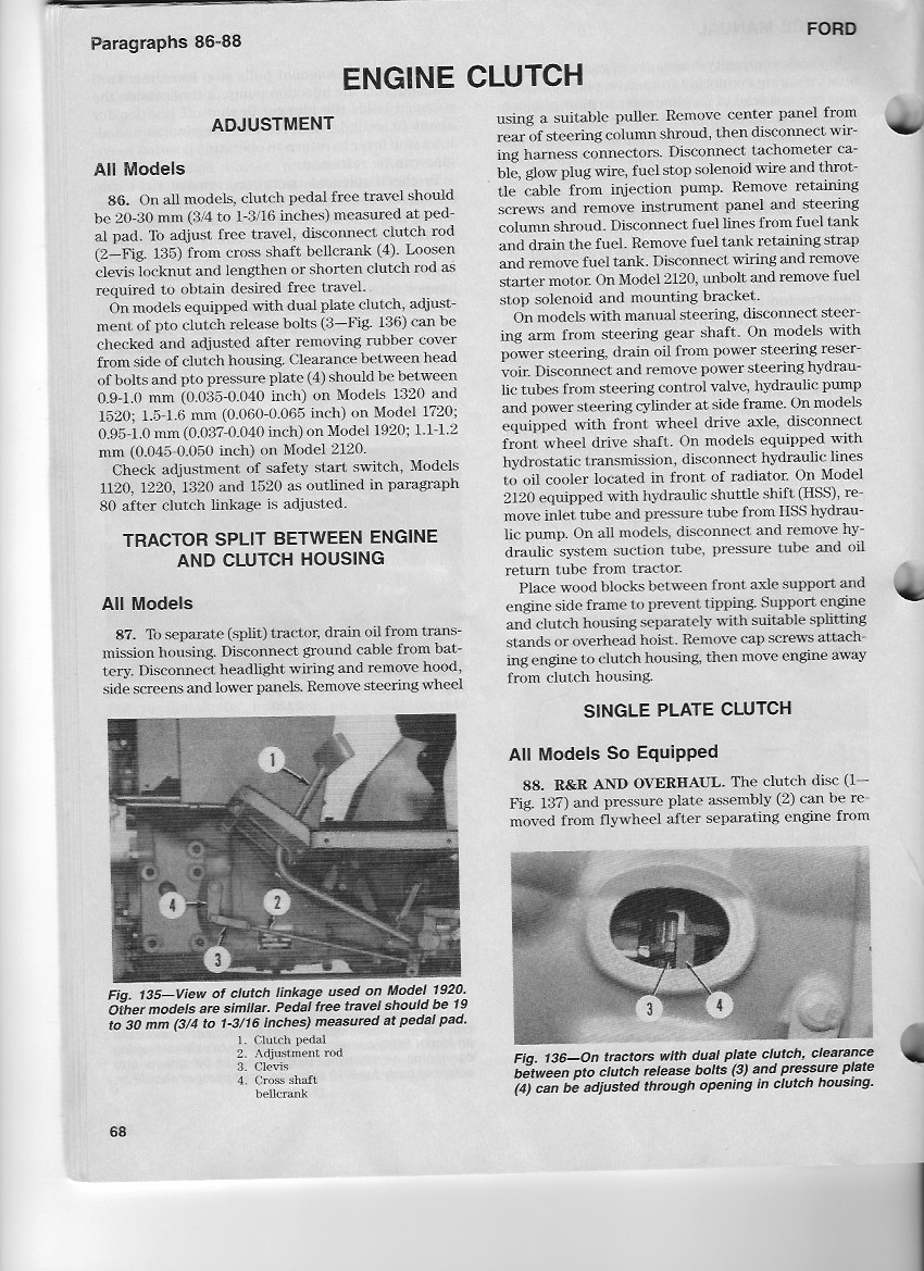

These might help a little.
  • FO46 Clutch Pages.pdf
