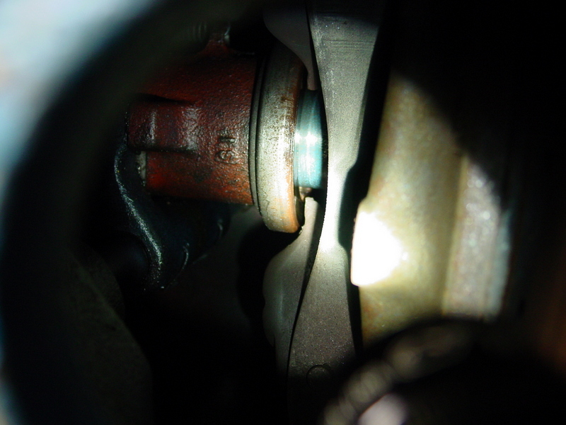

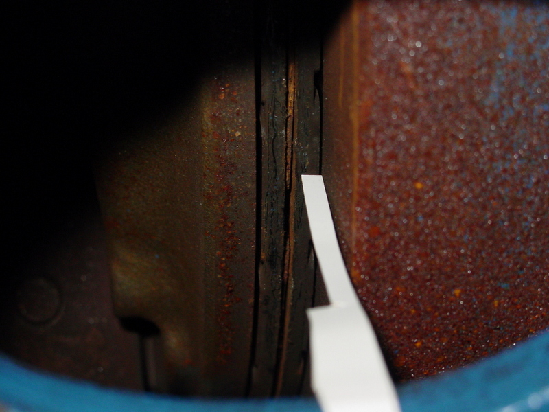

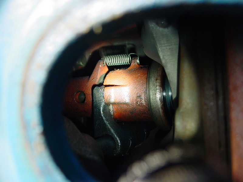

1- yes, throwout bearing is inside the tranny and is dry.
2- if you split a tractor to put some oil then might as well change the sealed bearing. They are always sealed for lifetime, whose lifetime? i don't know.
3- probably bad idea to squirt oil there as it should not get on clutch plate. On my 1700 there is an inspection hand hole that I take the rubber cap off and inspect. if you look at the attached pic the bearing is sealed and is too close to fingers on the pressure plate. I had to change a clutch on my son's car when the seal on the engine side leaked a bit of oil and got the friction plate contaminated. He could barely go up a 5 degree incline due to slippage.

Thanks for the pics ... yep that's what I remember.
The previous new throwout bearing also made noise from pretty much day one ... not sure if I bought a NH part or an off brand.
Hopefully it will last till next spring :)

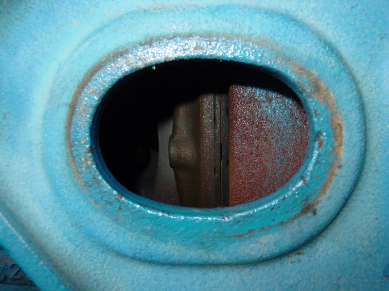

if throwout bearing is not riding on the pressure plate fingers then the only thing it can damage is itself only and nothing else. I don't reckon you have the hand hole on the side of Tranny to quickly check. I think that was an awesome thing to have. At least they should have a removeabel plug where you could send a scope to check. I can see the bottom of the housing if there is any oil leaking from the transmission input shaft or the flywheel side.

Yep ... the 1715 has no such convenient hole/plug .. not sure why when so many of the other aspects of this line of tractors is the same.
