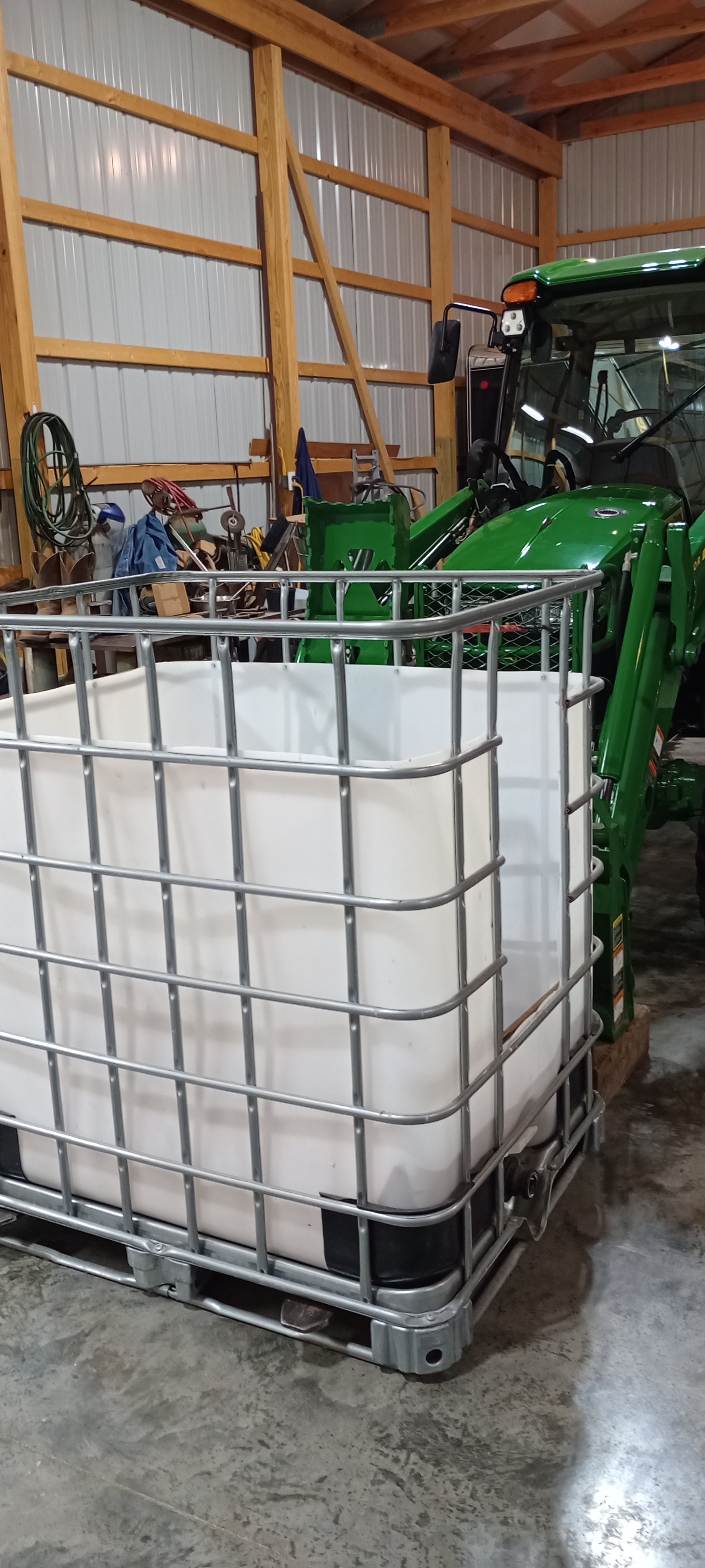

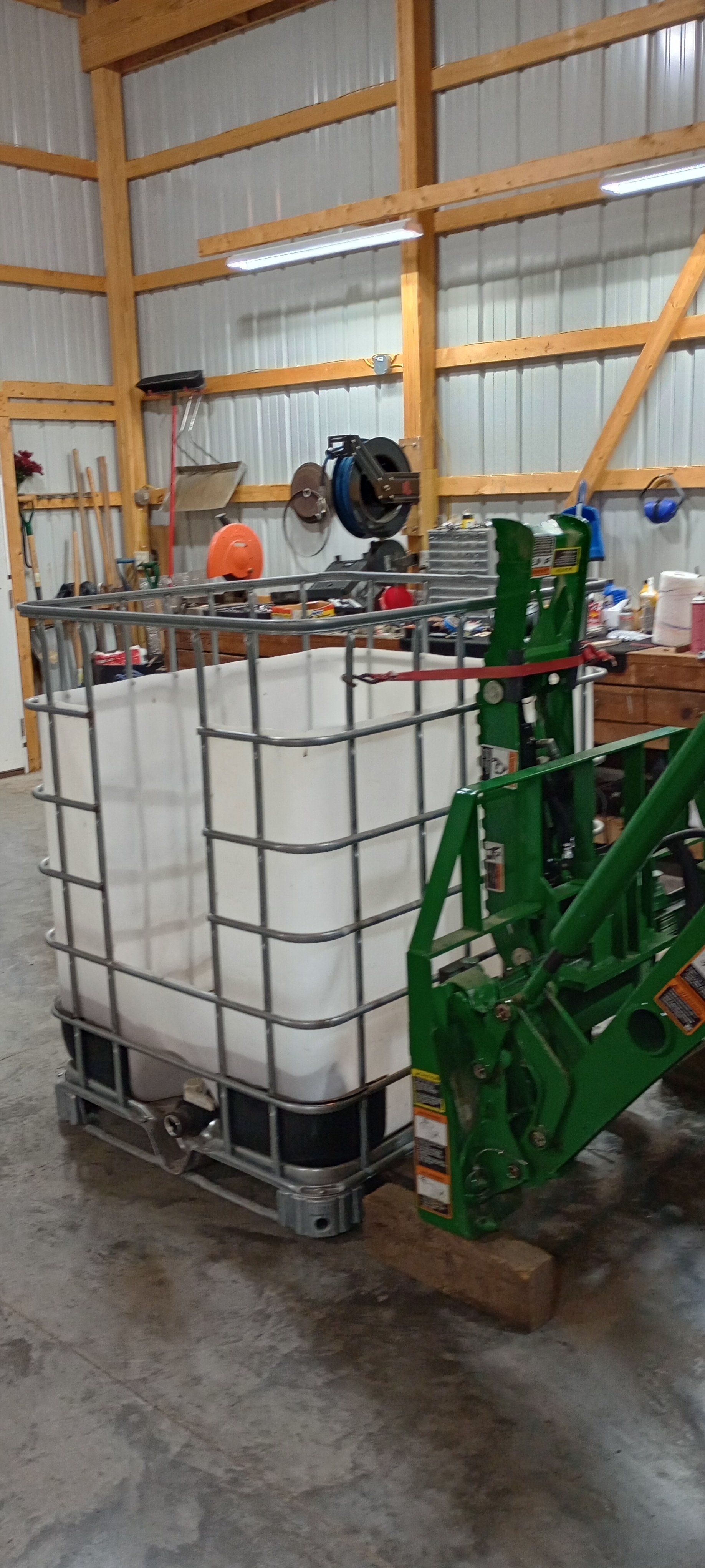

Hopefully the inside diameter stayed the same because it barely clears the driveshaft couplings. If the outside diameter is larger and fits tight on each end to keep it from spinning, it would be better. Let us know how it works for you. This time of year I don't use mine as much, except for downed trees and cleaning out gutters. If my wife lifts me up in this modified tote.

I believe they installed the new one on Wednesday, but I can take a few pictures and upload them. There is no ETA for repairs on mine, as they do not know why it's not lifting or why the new pump flows even less. It's flowing 1.5 gpm less than my prior tractor and 3.2 gpm less than the specs. I'm at the point where I would prefer it to be taken back. The fact that it showed up with the fan and front engine coated in thick oil makes me question the history of the tractor. Of course, the dealer refuses this, but I did in an email request to return in writing before the 30-day limit.
