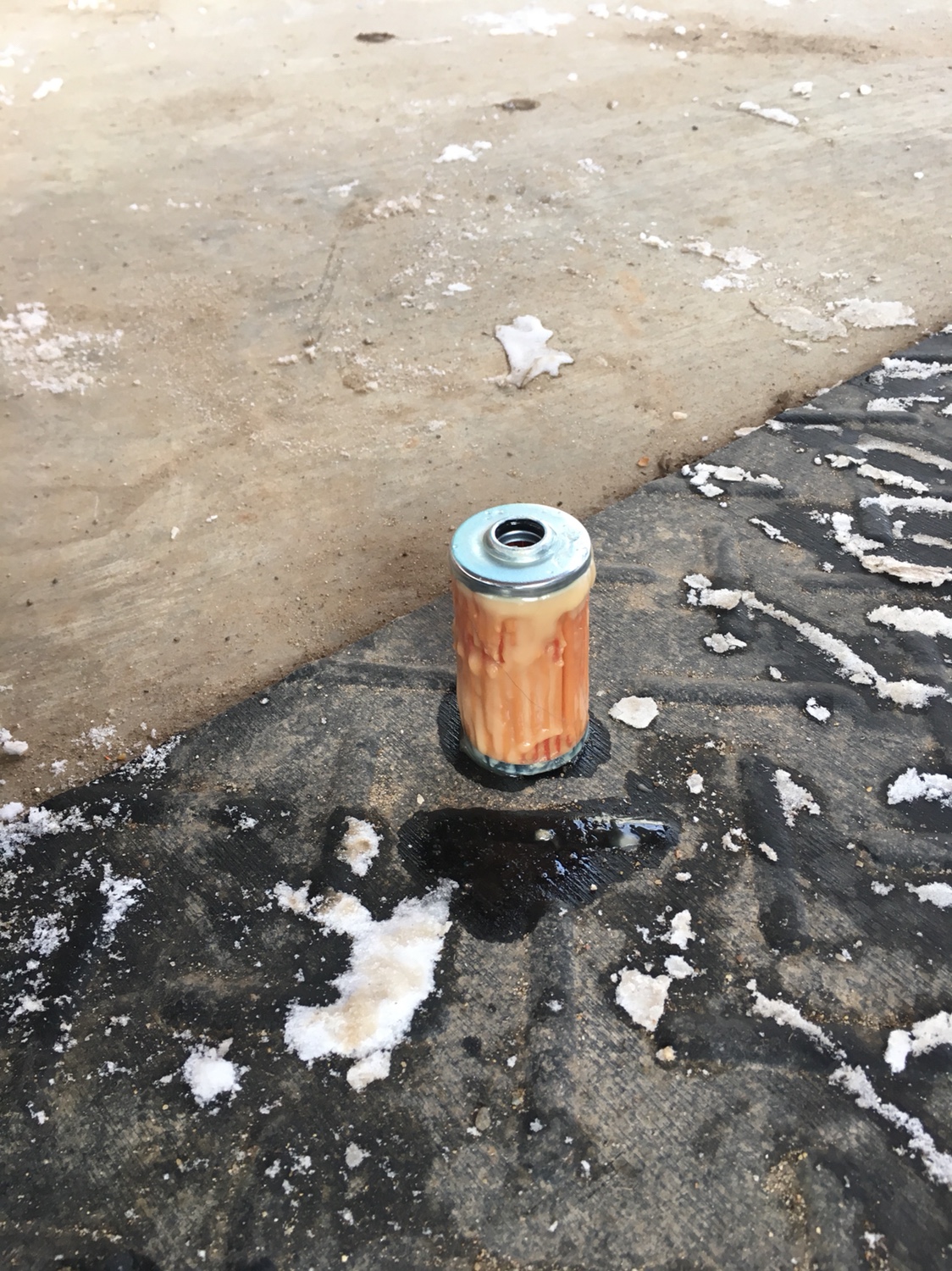

Just before the really cold temps hit us a couple weeks ago, I fueled up (from cans that have been sitting for a few weeks under cover) and added Power Service white bottle to the tank. I put in slightly more than the bottle recommended.
About a week ago, my dad was using the tractor in 5 degree weather with moderate wind to move a big hay bale to the cows. It sputtered and died while moving the bale. He ran a cord and a torpedo heater out to the tractor and ran it facing the engine/fuel system for a while and put 911 in the tank and it started up and finished the job.
A few days later, he was running it in 15 degree temps and it quit again. We took the fuel filter out and it was coated in a buttery substance, almost waxy. I ran to my dealer and got two fuel filters and put one on. It started up and finished the job.
What I don't understand is how the fuel gelled even after I put PS white bottle in the tank when I fueled up. I put plenty in, so that's not the issue. My dad thinks it was water or moisture in the fuel, but the filter was 80% coated in the yellow butter/wax and that's gelled fuel, right?
It runs fine now and it looks like we've got warmer temps coming (30s and 40s all week).

Like this! I had ice crystals under my fuel cap, I think running it in the -10 below stuff then letting it sit and doing it again causes some moisture to build up. Mine was fine without PS in the fridgid but when it warmed up in the teens it ran for about 10 minutes when it died and you can see the result....911 and new filter made it a 20 minute issue....
   / 1643 gelled up....
That's what my filter looked like: covered in a waxy, buttery goo.
As far as the fuel itself goes, the tractor's tank was about 1/2 full with fuel from October or November and I topped it off with a can that was filled in November. Perhaps all that fuel (or at least the fuel that was in the tractor since fall) wasn't "winter blend," and that's why the PS white bottle wasn't enough to keep it from gelling.

As I understand it (after half my life as a diesel mechanic in Wisconsin) the paraffin doesnt separate out.
What happens is that the paraffin molecules start to adhere to each other as the temperature gets colder. I believe this is the cloud point. Individual paraffin molecules easily pass thru the fuel filter. A whole bunch of them, stuck to each other, will not!
Gelling can be so severe that fuel wont even flow thru the fuel lines.
Most (not all) diesel fuel anti-gel additives work by coating each parafin molecule, which keeps them from sticking to each other. Otherwise, they form a mass (gel, goo) that will not pass the fuel filter. Once the molecules begin to stick to each other (cloud point) very few anti-gel additives will un-gel the fuel. The fuel must be warm enough that the parafin molecules are not sticking to each other to begin with for the additive to be effective. Adding anti-gel to clouded fuel usually won't work unless the fuel is then warmed back up to the point that the parafin molecules separate. Then the additive KEEPS them from sticking.
Back in the day, only Power Service brand anti-gel could un-gel a filter.
We equipped our Class 8 tractors with fuel heaters in the fuel tank. This device used hot engine coolant to heat the fuel and keep the molecules separated enough to pass the filter. And we still used winter-blended fuel.
