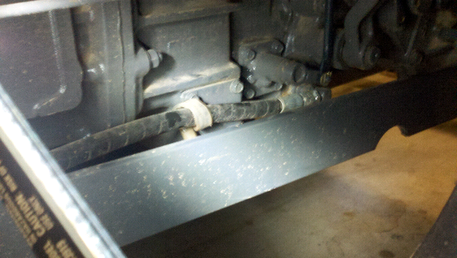

Ok, got my filter send to me from the dealer. Got them yesterday. Well I got an air filter for a cab I do not have, and no transmission filter. Got to love not having a dealer close.
Here is my next question for the 1643 owner, in the picture I attached is that where the transmission filter lives?
Also what is a good replacement for the Permatrans III?

/ 1643 Filters #10
Glad you got at least some of the filters you needed!
On the Permatran question, your manual may list the specs you need to match up for any other oil.

What your picture shows is just the trans. filter screen. It's really expensive to replace. You can just pull it out and clean it in a parts washer and use it again. It's just a metal mesh screen with pleats. The trans. filter is under neath just behind the front bumper. Climb under there and it's really easy to see. It should be a white spin on type filter. (my 1652 is the DynaQPS trans. so that's all I know. Your's may be different.

Thanks MF1652. I did not know it was a mess that can be cleaned.
Yeah the filter up front on my tractor is called a powersteering filter.

If you have a power powershuttle you will have 2. One in front of the front axle which is a spin on and one in back that is cleanable. If I remember they call the front one a power steering filter.

The filter for the hydro should still be under the step, can't remember what side. The one above the front axle is for the entire system. It is one common reservoir.
Has anyone priced the Powershuttle filter in the belly, the cleanable one??
