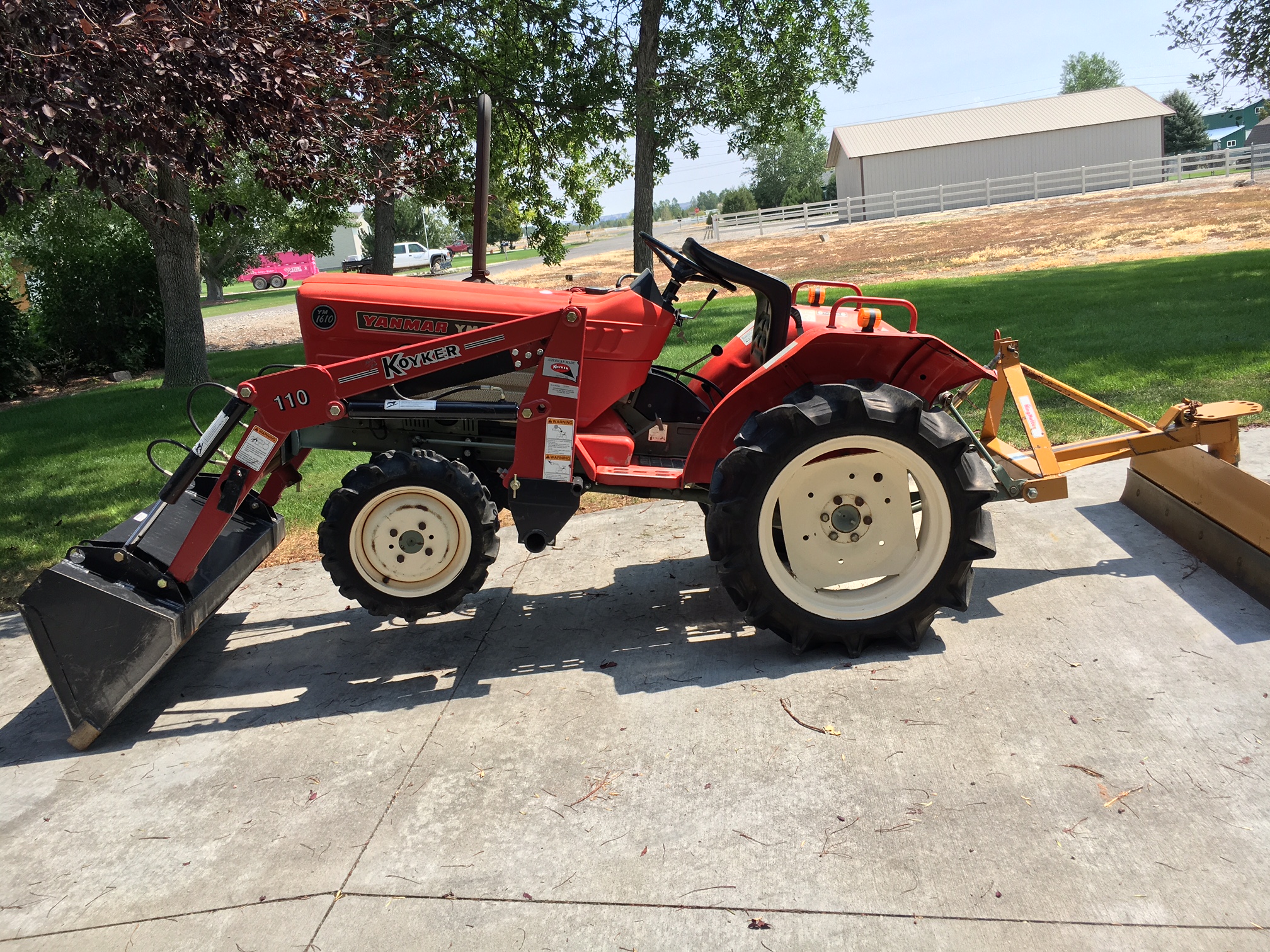

I'm thinking of making an offer on a 1610d with a Koyker 110 loader. Everything seems to work as it should and it rides nice (although I have no experience to compare it to).

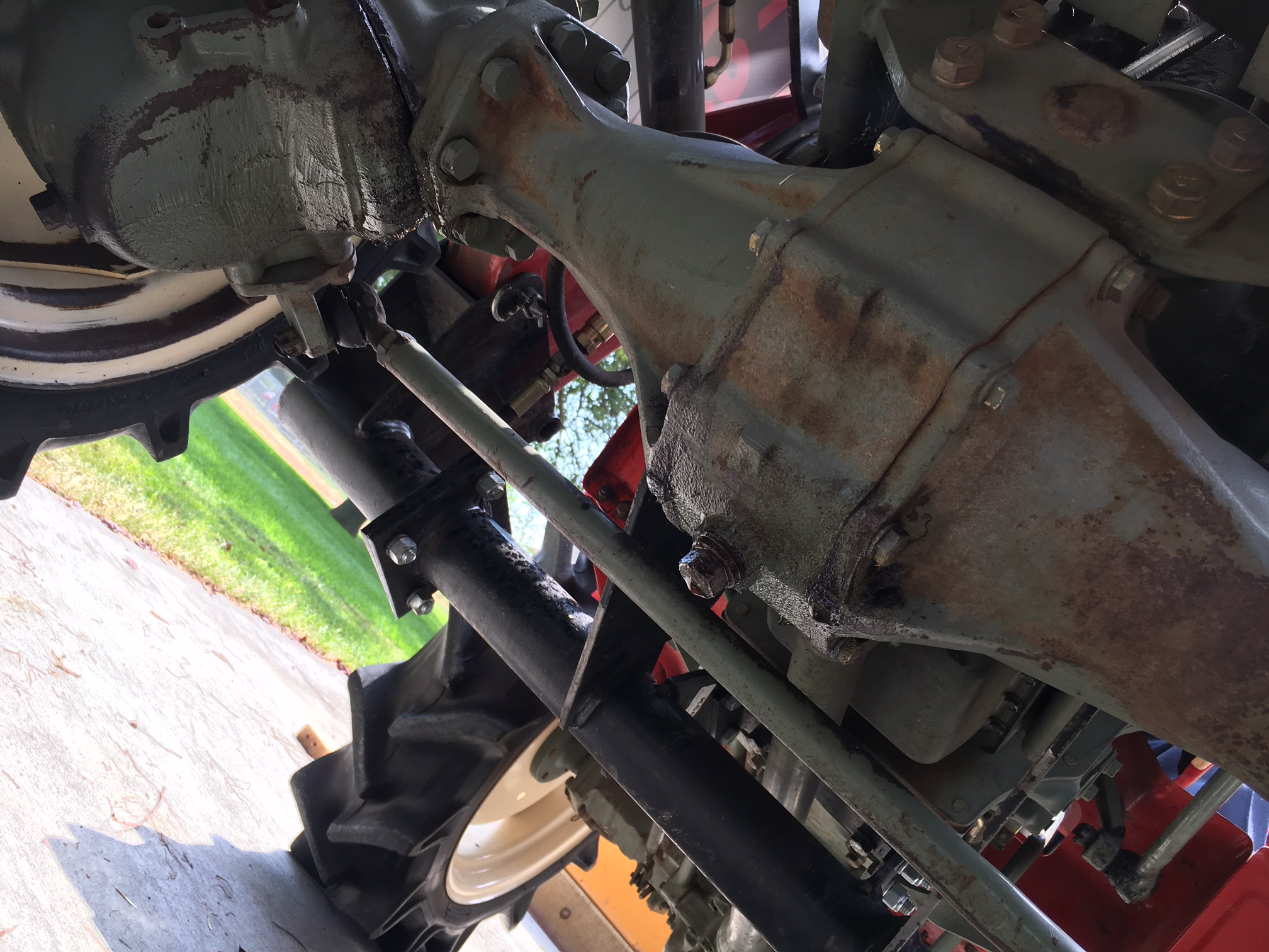

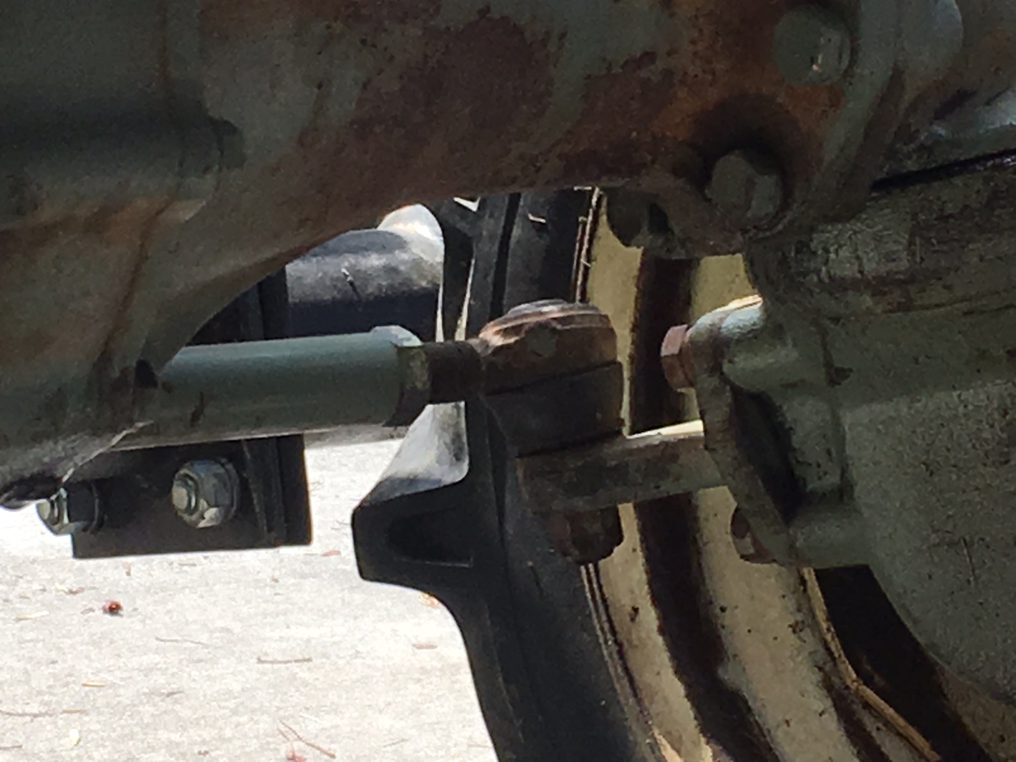

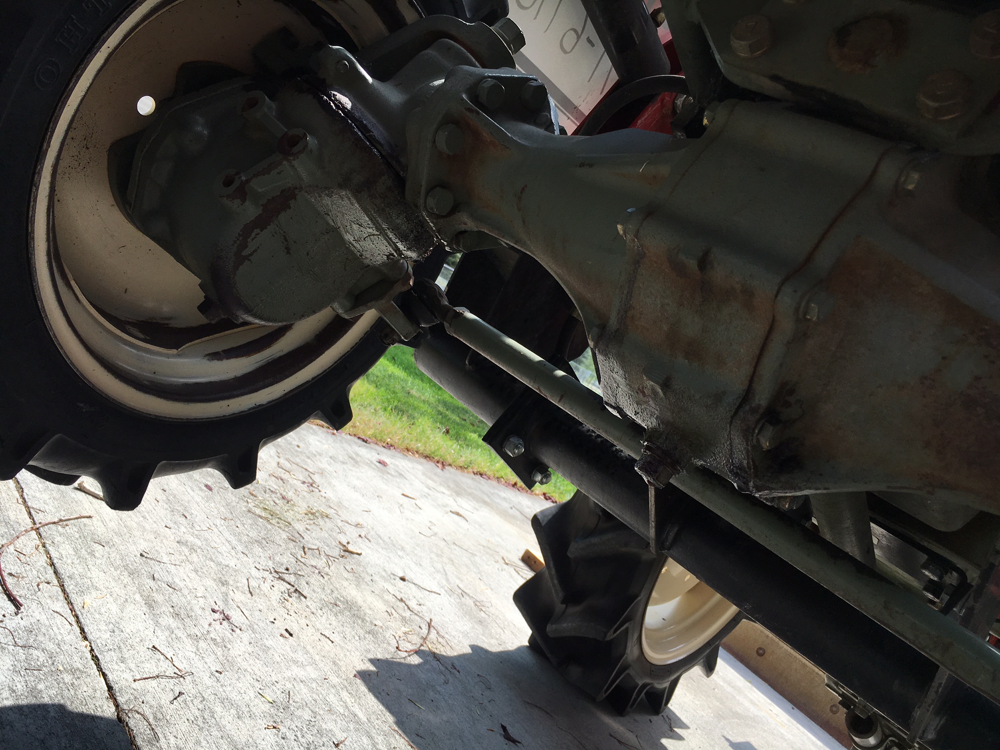

Both of the front wheel hubs are leaking as is the front differential. Enough that I could see spots on the gravel where it was parked. I don't think it is possible that the differential leak could run down to both axles but I can't completely rule it out.
I would like to make the owner an offer but feel I need to take into account worst case scenario parts and labor to have it repaired.
Also the brakes are very weak and possibly not working at all. While that might be a simple adjustment I need to take into account worst case scenario on that also.
Tractor doesn't have ROPS but does look to have the PTO guard.
Pics attached.
What's it worth?
Thanks.

Brake shoes are $85 or so, and the drum is most likely fine. If you need seals for it if there leaking add $40 for both sides. This is if you do the brakes your self. But there is a good bit of adjustment on them that is just a turnbuckle that you tighten to allow the petal to push them out farther.
The front knuckle is a common problem but I don't remember the parts and I don't think its a terrible job for a DIYer just a pain to do all that work for a small leak. The diff leak is possibly just a gasket as well. But I wouldn't think your looking at $100 or parts for those leaks and that would again be doing it yourself. If your paying someone could start anywhere from $30-$120 an hour and up depending on if its a local shade tree guy or you take it to a tractor shop. Brakes can be done assuming the cams are not stuck in just a short period if you know what your doing. the replacement can be done easily in 2 hours, adjustment can be done in 10 mins. Front seals I would imagne a half a day for all of them at worst? But I don't know.
   / 1610d with leaking front hubs: Worst case scenario to repair? #4
Yep has 3 separate leaks, swivel hubs and axle tube by the looks of it.
