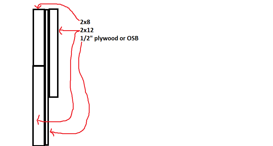

Here is what I am thinking right now.
option 1:
A 2x8 on top of a 2x12 joined with 1/2" plywood or OSB. Thus making a 2" wide and 18.5" deep beam. Adding a 2x12 behind it to add to lateral stability and overall strength. Doing the 2x12 behind is the reason for the 2x8 being on top...so they overlap.
The resulting 2x18.5" beam figuring the strength (Moment of inertia), using the formula (W x H^3)/12 I get an i^4 of 1055. And for the 2x12 it would be 178.
So the sum of the beam strength would be 1233

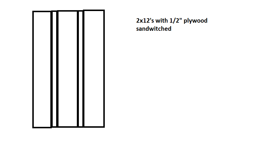

Option 2:
Using the more common method of 3 2x12's with 2 layers of plywood result in a 5" x 11.25" beam.
The relative strength of that beam would be 593. Or less than half of what the larger beam is, AND requiring more material, being heavier, and costing more. Only advantage of this is more strength in the y-axis.
Given that I have plenty of height, any reason no to use option 1? Or any better solutions that arent gonna break the bank?

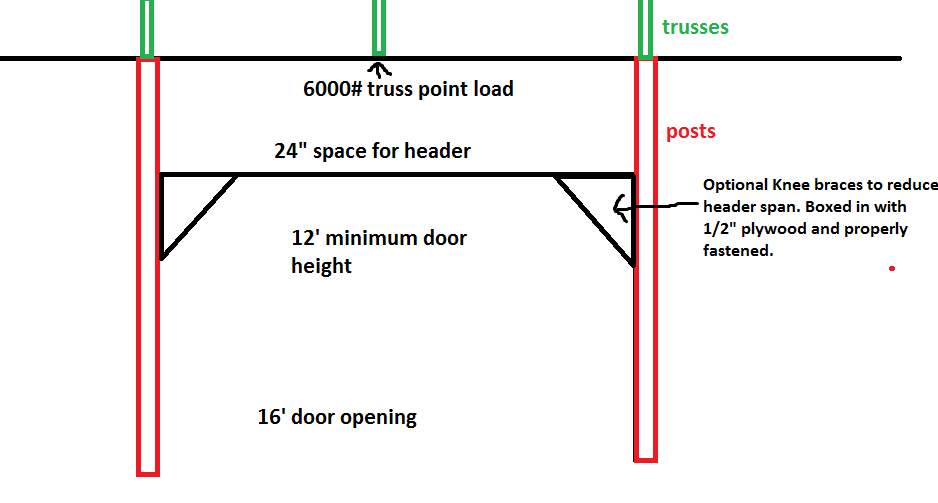

   / 16' opening Door header: on load bearing wall
Here is the bigger picture to help get a visual.
Again, I have plenty of height (depth of beam) to work with. And with a given amount of material, more strength is gain by depth than width. So my emphasis to go deeper instead of 3 or 4 plies wide to get the same end result.
Also considering adding some knee braces to further reduce the effective span of the header. But this is just for extra measures. I want a beam that the knee braces are not needed for strength, but rather a extra bonus if I decide to add them. Same with the metal siding. IT will add a bit of strength to the beam itself, but leave that be a bonus.
Final question before I wait for some responses........
With the load being right in the middle of the 16' span, how would you section the plywood? Would you use 2 8' lengths with the joint right where the load is? or would you go 4-8-4 and have an extra joint, but being farthest from the load?
