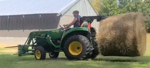

I would have to agree with others here that if the load is 2000 pounds I would not want to be using an MX series tractor for going any kind of distance with that load. I would think the M series of Kubota or equivalent other manufacture would be the way to go.
Just my 2 cents.
   / 16 acres and a hobby farm what tractor? #42

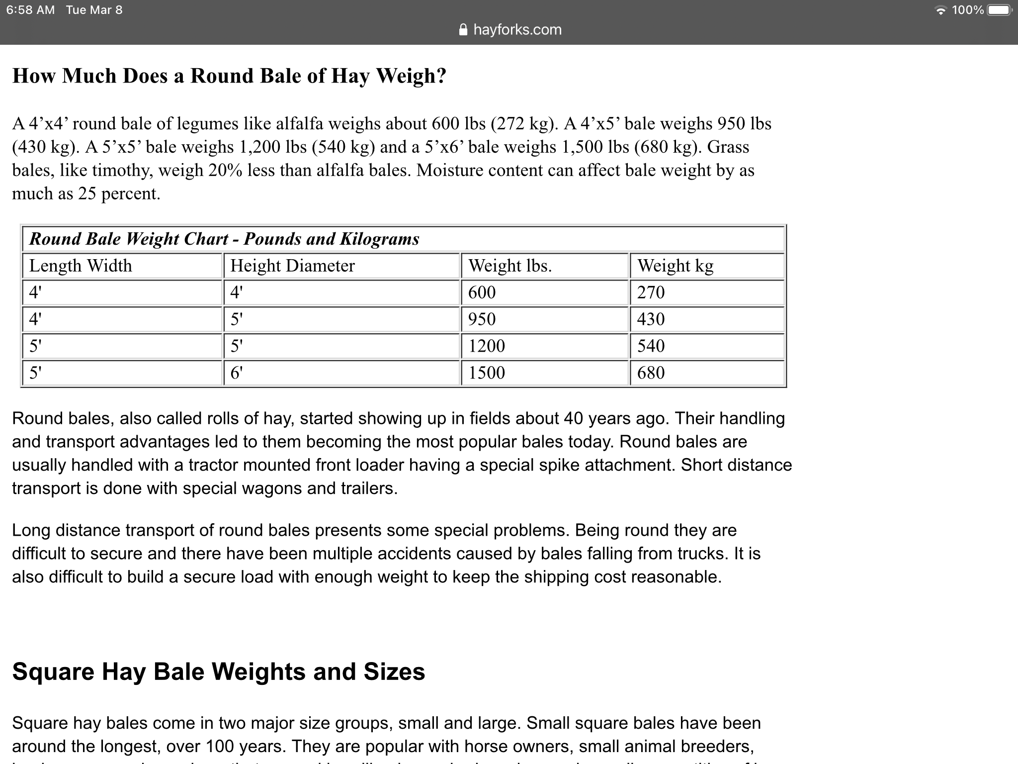

Fair enough. I was going by 5’ in diameter.
Might be a regional thing?
6’x5’ bale is much bigger, but still have a hard time seeing 2000lbs from one.
When I was rolling hay, I had a NH688 and I rolled 52 inch bales (4.33ft in diameter) of grass hay at about 12% moisture and they averaged 1250 lbs each by actual scale weight. Scaling this up to 5 ft gives (D^2) gives 1664 lbs. Alfalfa would be even greater. According to this chart, a 5x5 bale would weigh 1200 lbs. All I can conclude is that the bales in this chart were rolled at a lower bale density and/or a lower moisture content then the bales I rolled.
I handled bales with a FEL spear and a bale spinner on the 3 point with my Ford 4610 and moved up to a NH TD95D. I can tell you from experience that the NH does a much better job than that Ford. But I would never think of handling round bales with anything less that that 4610.
My point was if you are going to handle round bales, you aren't going to do it safely with a small tractor. My definition of small is less than 50 hp and <~5000 lbs in weight. You also need a front axle that will withstand the weigh of a FEL with loads. Now the OP says he only needs 2 round bales a year. That's today. What about 2 years from now?
It's his money and his choice. I'm just trying to give him the benefit of my experience. I started out with a TO-30 (28 engine HP) moved to a Ford 4610 (60 engine HP) and then to a NH TD95D (95 engine HP) when I started baling.
'Nuff said

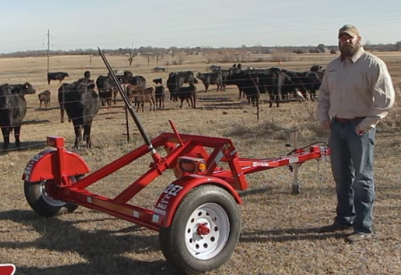

You have lots of options to consider:
  • Keep your B2650 and buy a used Farm Utility Tractor with a loader capable of moving those bales
  • Buy a 50-60hp CUT with strong loader and all new implements
  • Buy a new 30-40hp CUT with 3pt bale mover, keep your implements
  • Keep your B2650 + implements, Build/Buy a Trailer Bale Mover, buy a rough cut mower with the $$ you save 1646770958225.png
There is so much wrong with this video, but those bale mover trailers work better than I thought
   / 16 acres and a hobby farm what tractor? #44
If you need to keep a budget one of these would move a heavy bale with little strain on your current tractor. It is not ideal but for a few bales it would be good. Watch FB and CL for a used one.
Yep. I was reading to the end before commenting on this solution.
Keep the tractor you have. Buy a trailer like this. You'll save thousands of dollars. And you won't be back on here complaining about how the larger tractor you bought tears up your lawn when mowing. You think your lawn is rough now. Mow it a couple years with a 5K lb tractor.....
