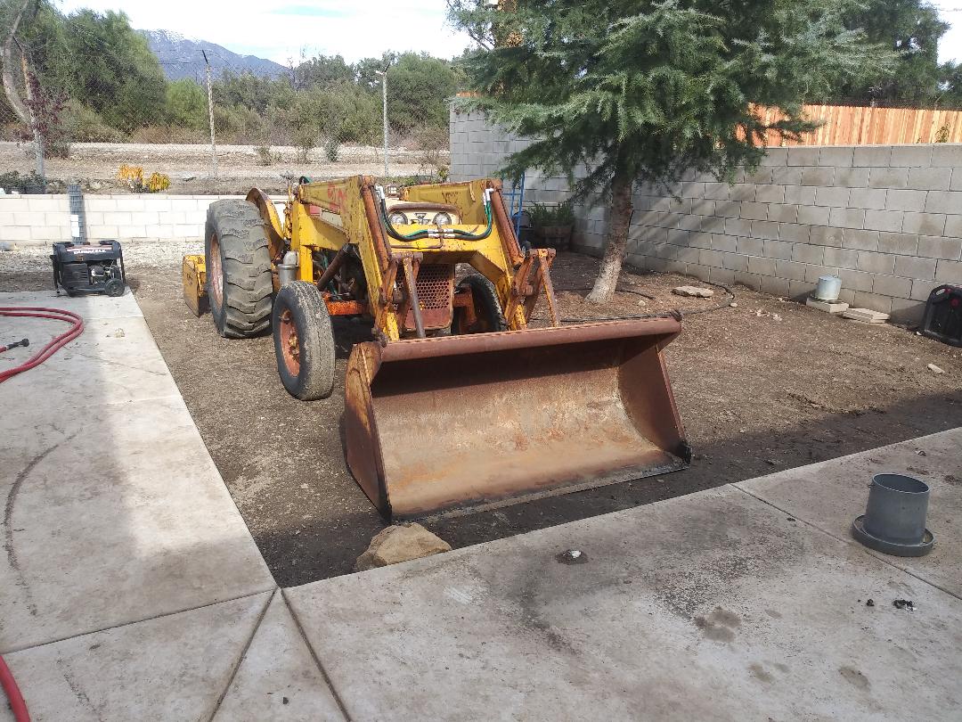

My massey Ferguson 202 is in need of a pair of rear tires. It currently has 14.9-24"s has anyone out there run 16.9-24 on a MF202 I'm also considering using 15" wide rims . 20191202_123256 (1).jpg

My massey Ferguson 202 is in need of a pair of rear tires. It currently has 14.9-24"s has anyone out there run 16.9-24 on a MF202 I'm also considering using 15" wide rims .View attachment 633793
It looks like this guy in the photo went with larger rims. Width doesn't change much but diameter can effect travel speed and torque in each gear. I like the look of bigger tires. More width would give better floatation in soft soils.
It looks like you could use new tires anyway so the additional cost of the rims are what you would need to consider. Its not a huge expense.
