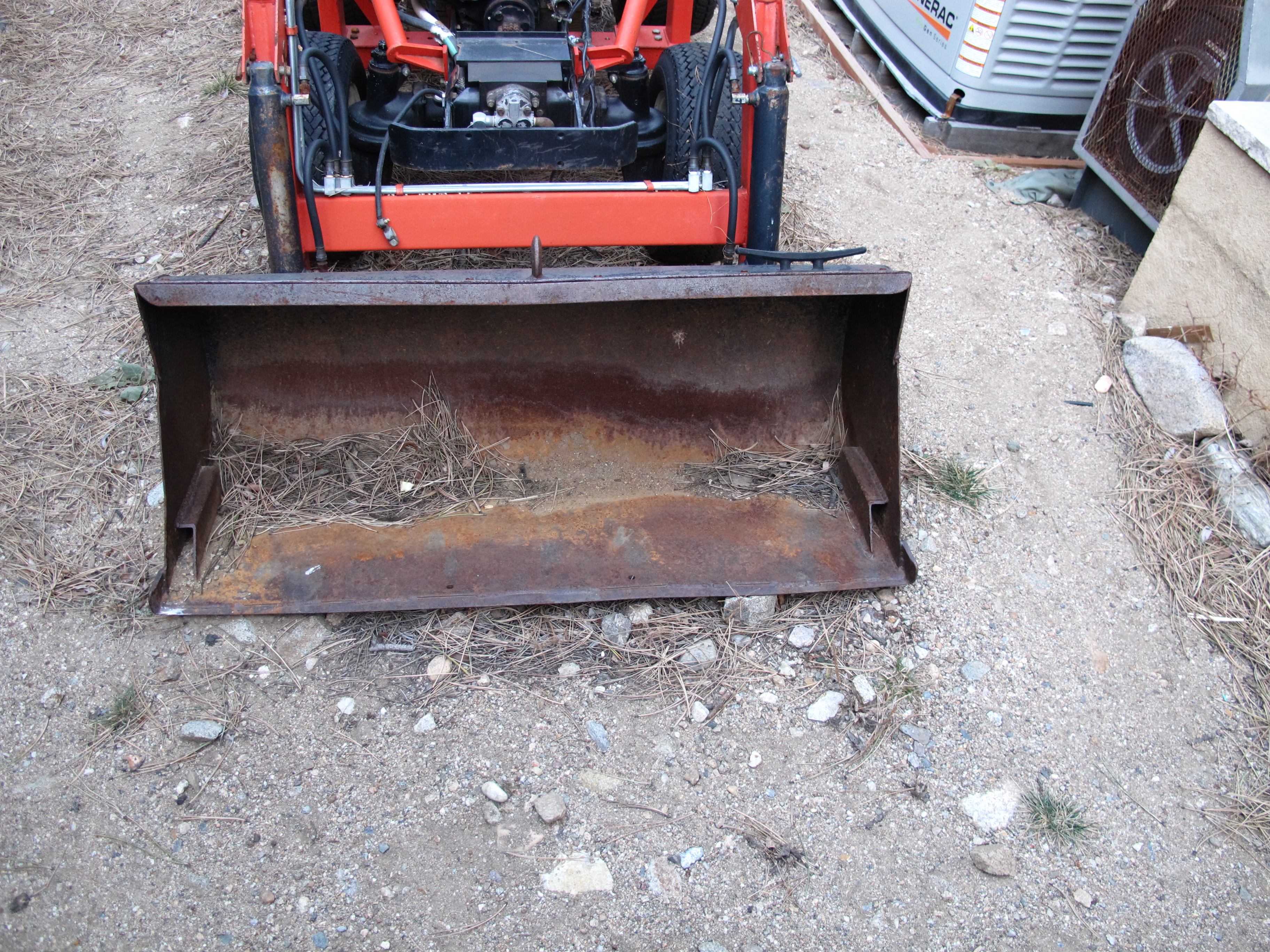

What I did for forks for the YM165 - same loader as the 155 - was to go to the scrap bin where I found some angle iron and a couple of four foot pieces of heavy wall steel pipe. I welded the angle iron into the sides of the bucket as you see in the photo. Now when I need forks I just slide the pipe into the brackets welded into the bucket. Plenty strong enough for anything that small loader can lift.
rScotty
Perfect
