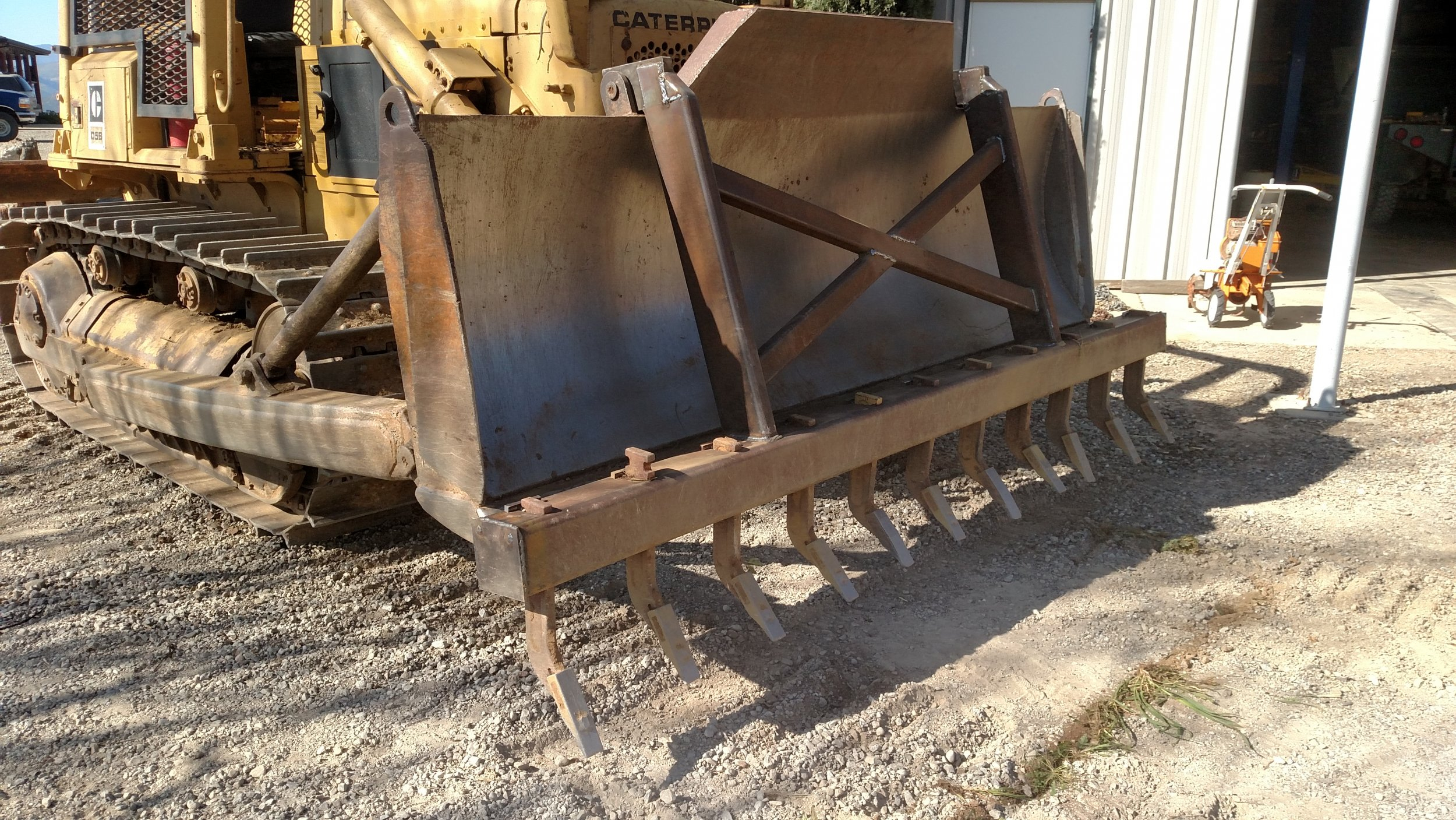

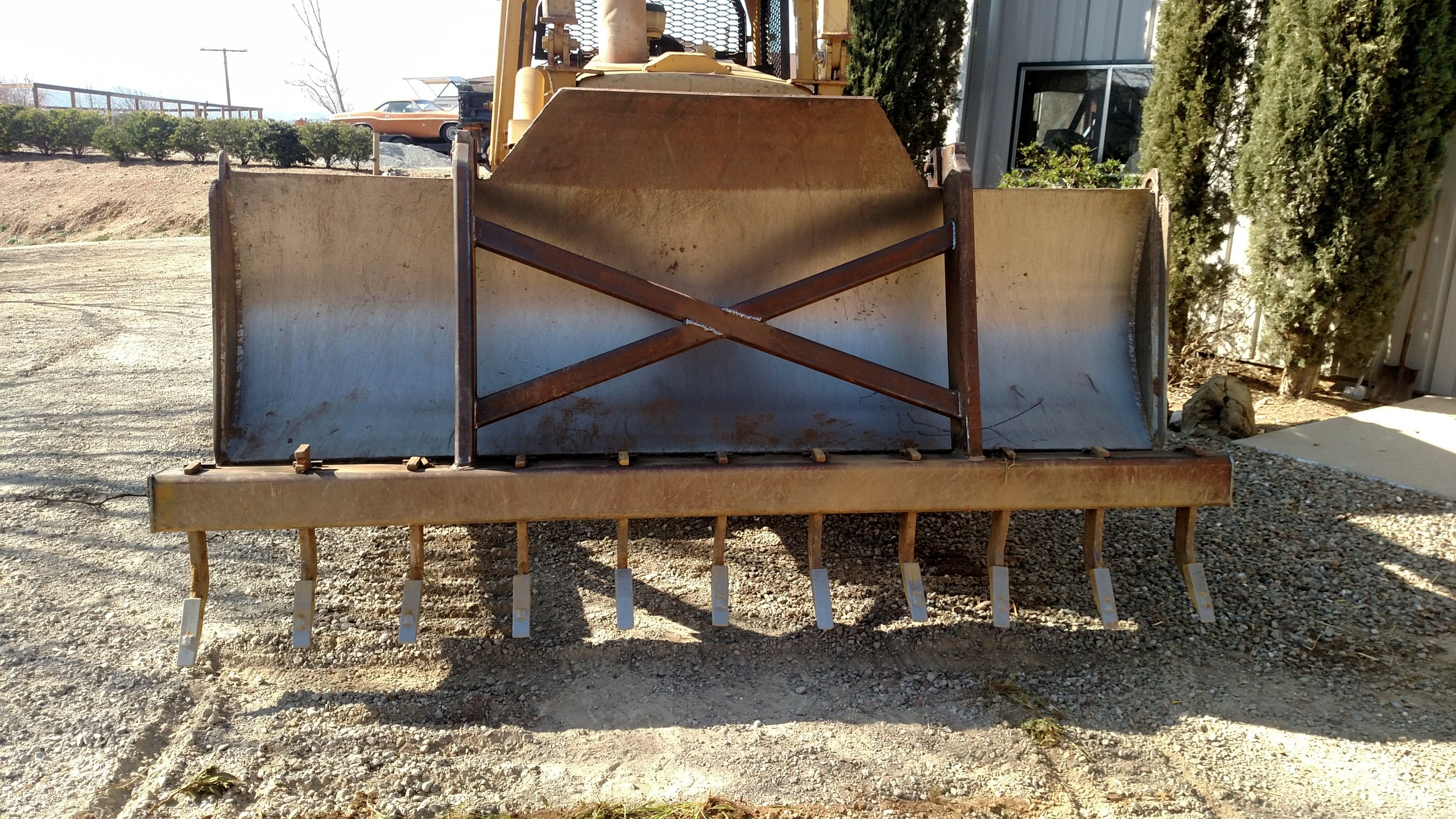

I've removed countless ground squirrel mounds using my D5 with a brush/root rake. I built it in the shop with 6” box tubing and replaceable Cat scarifier shanks.

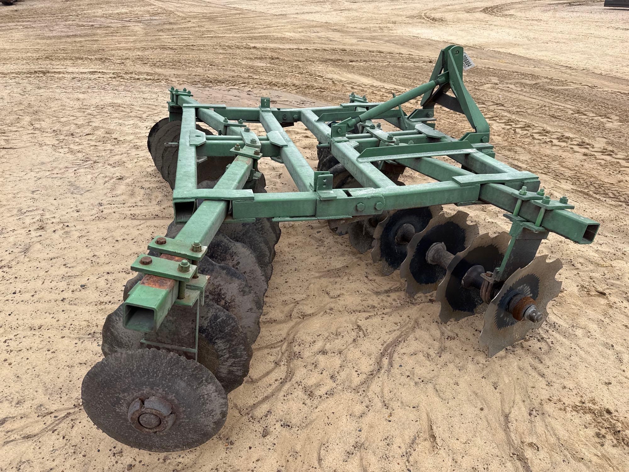

I built this for our place.
Hootens in Emory sells one very similar.
Need to keep every field that you want bailed free of the mounds. The critters bring rocks up with the dirt and when a mower hits them, glass is broken out.
I’d start preying now that once you turn your dirt you don’t have an invasion of pigs come in and make it even worse than it is now.
Welcome to East Texas…
