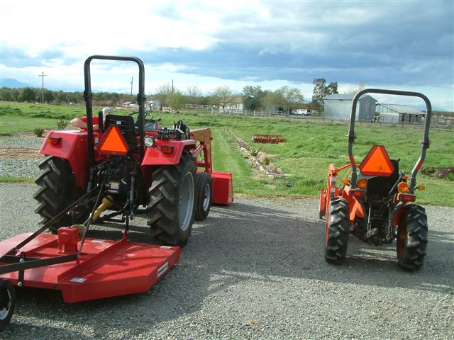

Check the squat ratio of your tractor (width of the rear tire track measured to the outside of the tires divided by the height of the centerline of the rear axle). If that ratio is less than 3.0, you need to be concerned about stability.
For example, the SR of my 2008 Mahindra 5525 is 2.84 while the SR of my 1964 MF135 diesel is 4.15. The difference: the 5525 has typical ag type rear tires with 28" dia rims and a 71" track width. The 135 has 16" dia rims, 18.5 in dia tires and an 83" track width.
Here's the 5525 next to the 2005 Kubota B7510HST (which I traded in as part of the 5525 deal). That 7510 is pretty close in size and configuration to your BX25.
This is the MF135. It's a field tractor that's be modified for use in the orchard where it has to squat low to pass under tree branches. The front axle spindles are shorter to keep the tractor level when running those wide rears. My place is 10 acres of flat pasture, so the slope problem doesn't arise. But the 135 would be choice to mow on slopes like yours.

Your MMM helps a lot to lower the center of gravity of your BX25.
