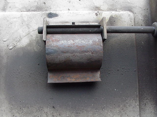

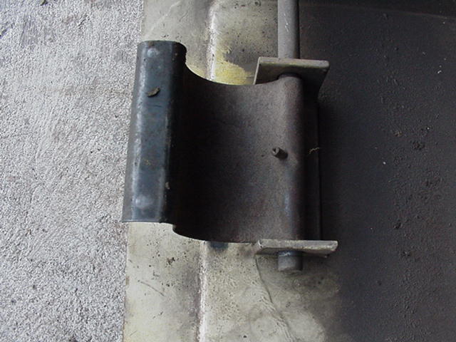

My 1450 has the two check valves on top of the Hydro unit, with plungers to release them for pushing/towing. I have the lever, but the part to push down on the valves is missing. My Cub dealer tells me that it is discontinued. It was missing when I got the tractor.
I don't even know what this part looks like. Is there any source for these, or does someone have a work-around?
Thanks!

   / 1450 Hydro release lever #4
Porchdog,
Here's what you need.
Thanks Guys!
That website is pretty good. I think I'm going to check out a few junkyards before I drop $30. including shipping, but now I know what I need.
