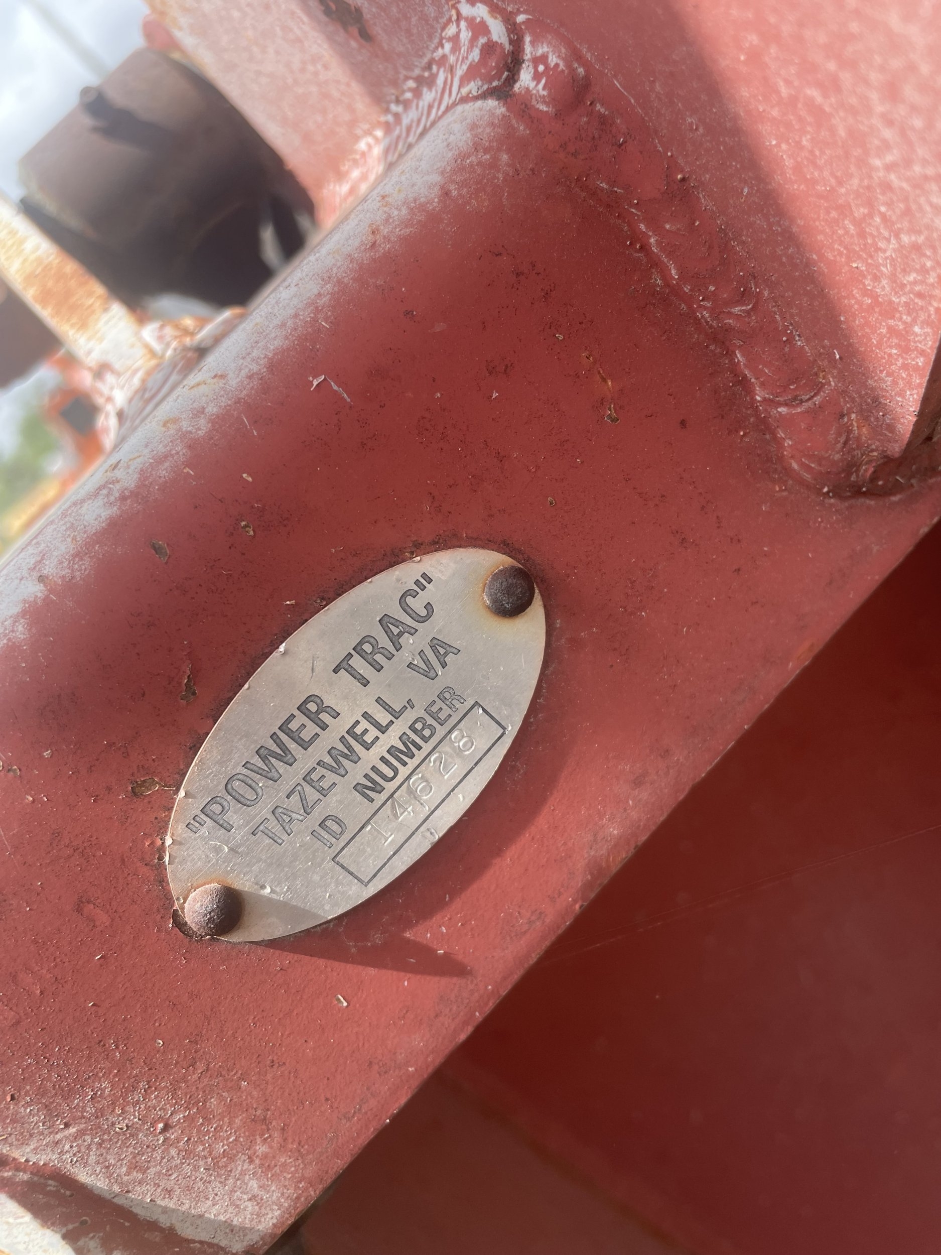

Welcome. Post some pictures and we can chime in on the vintage. (Or call PT with the S/N)

You teased us with the SN plate. Where's the rest?

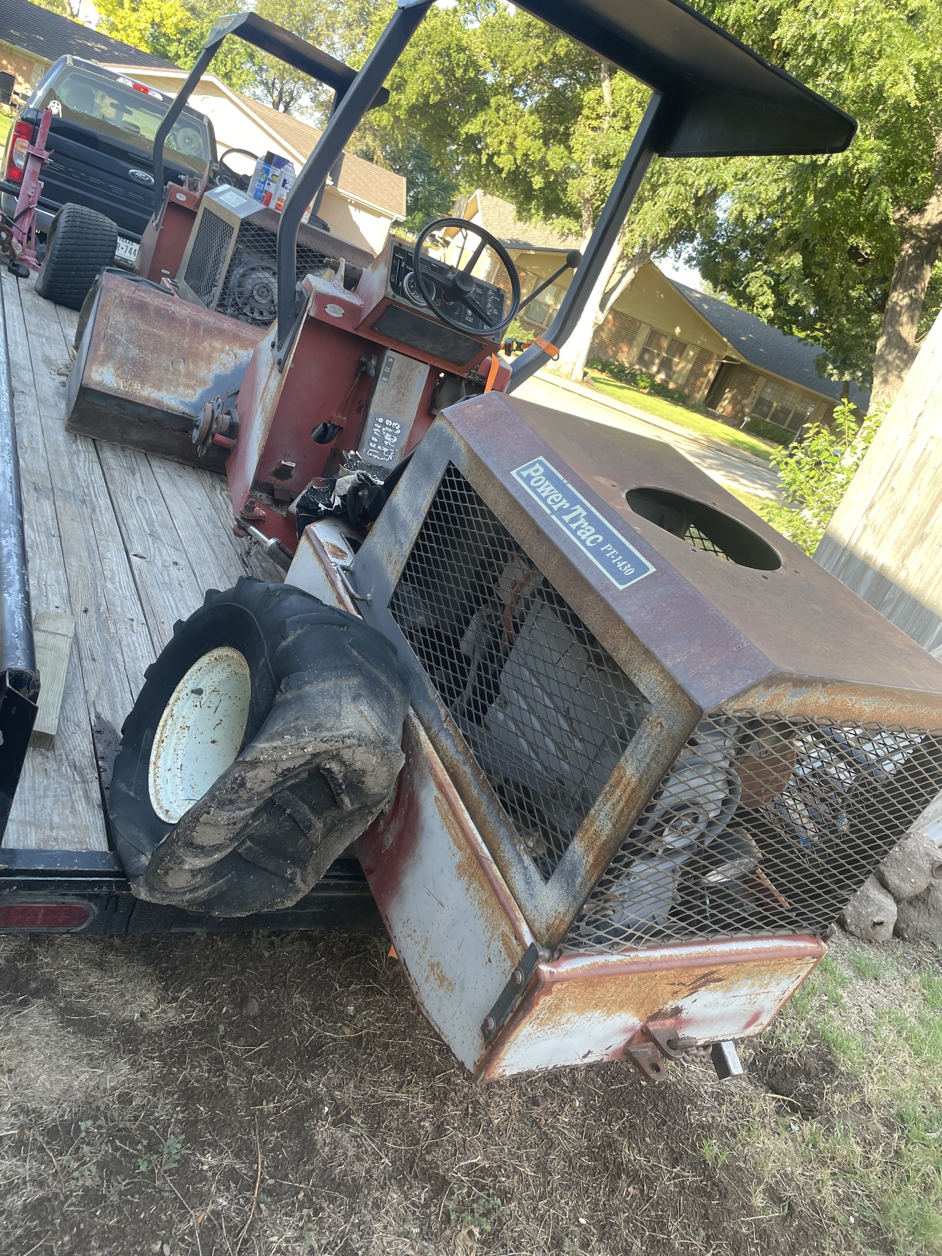

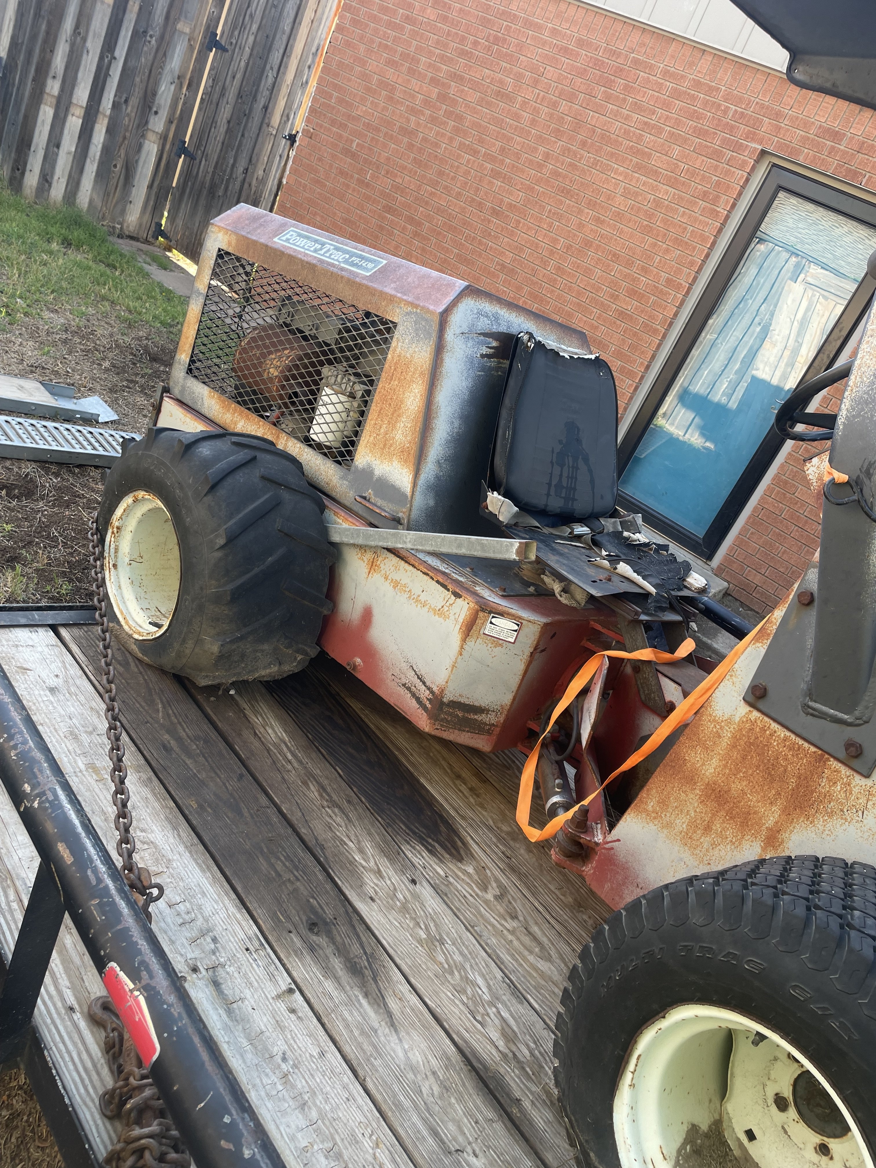

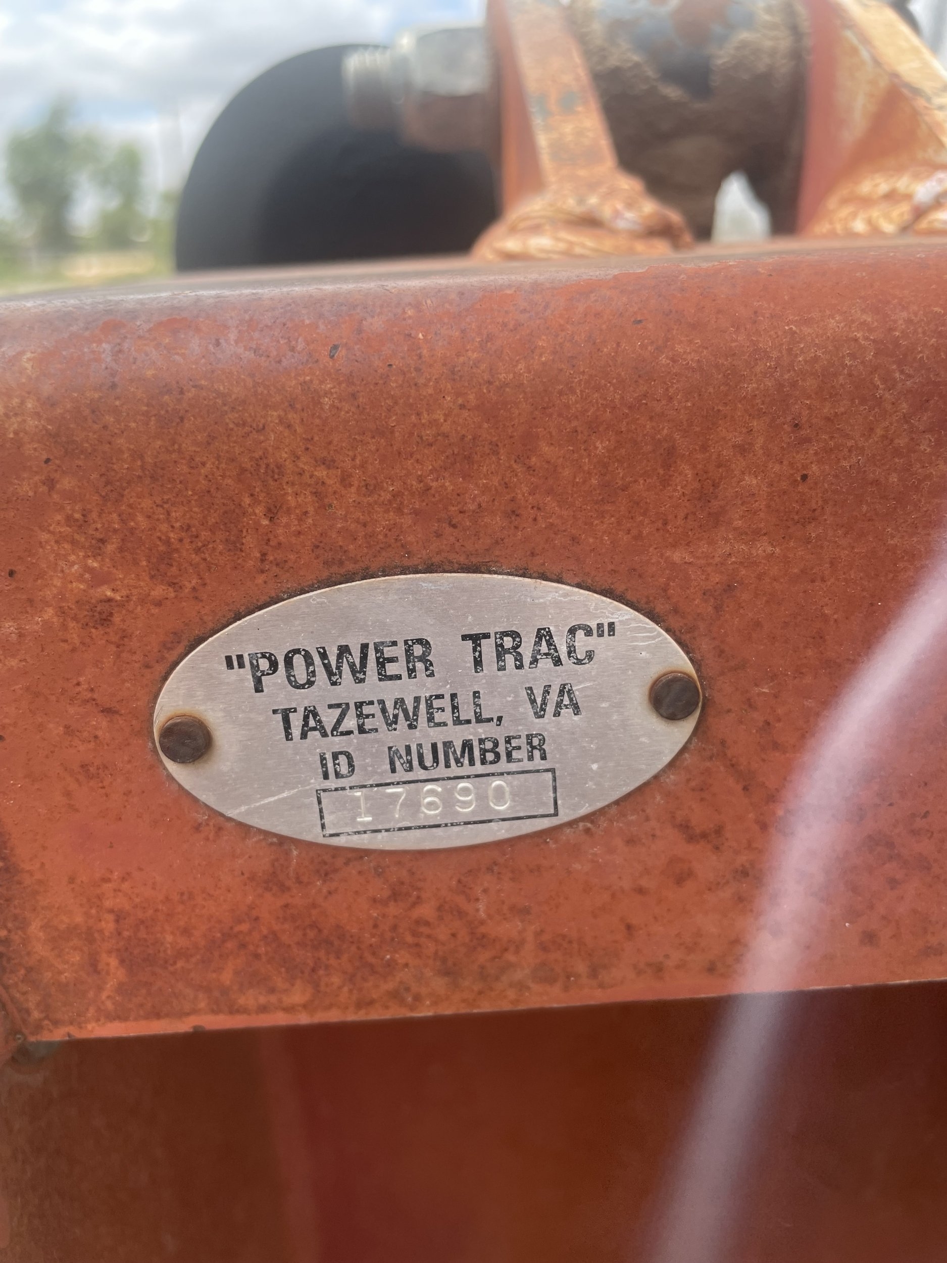

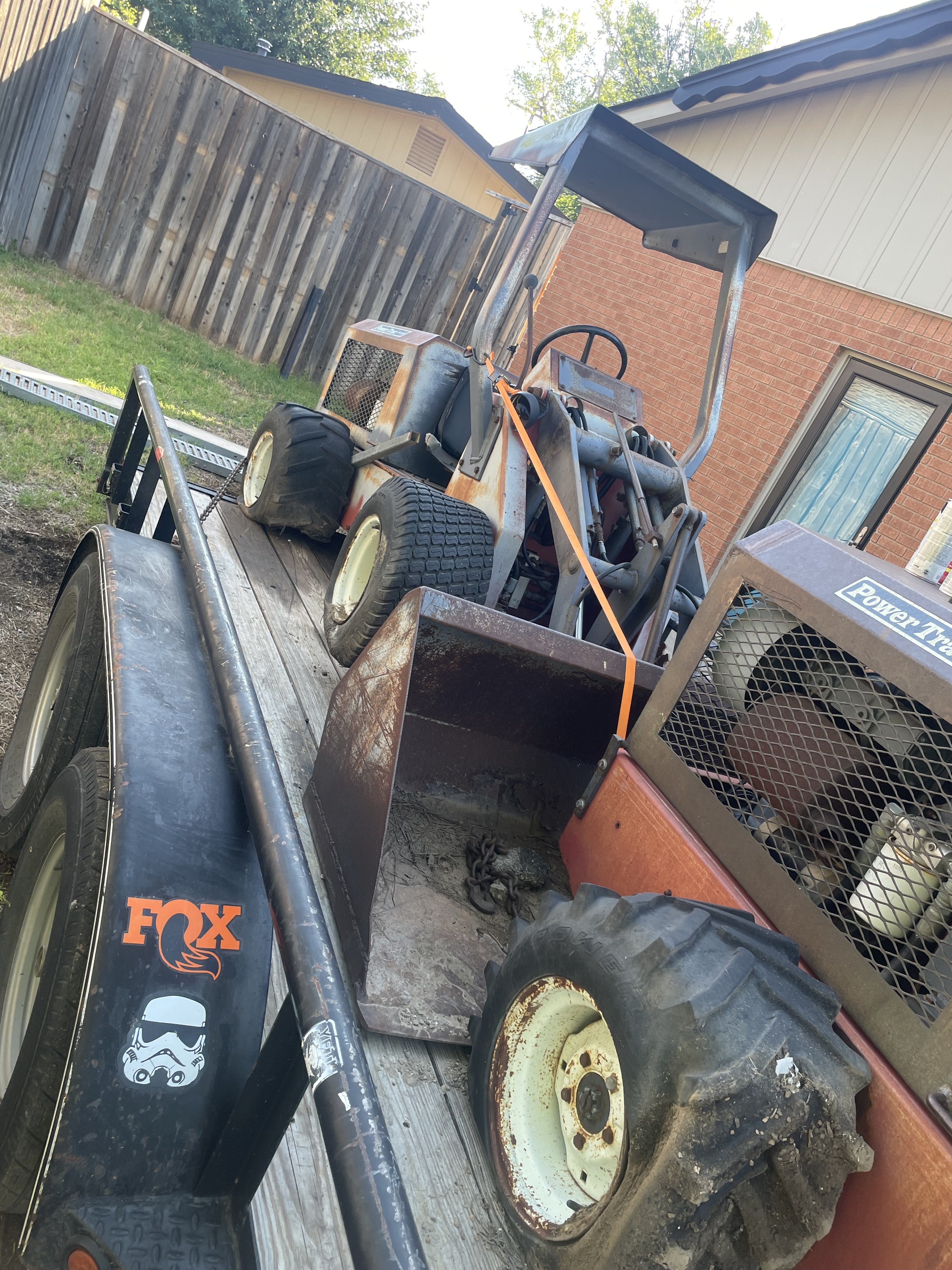

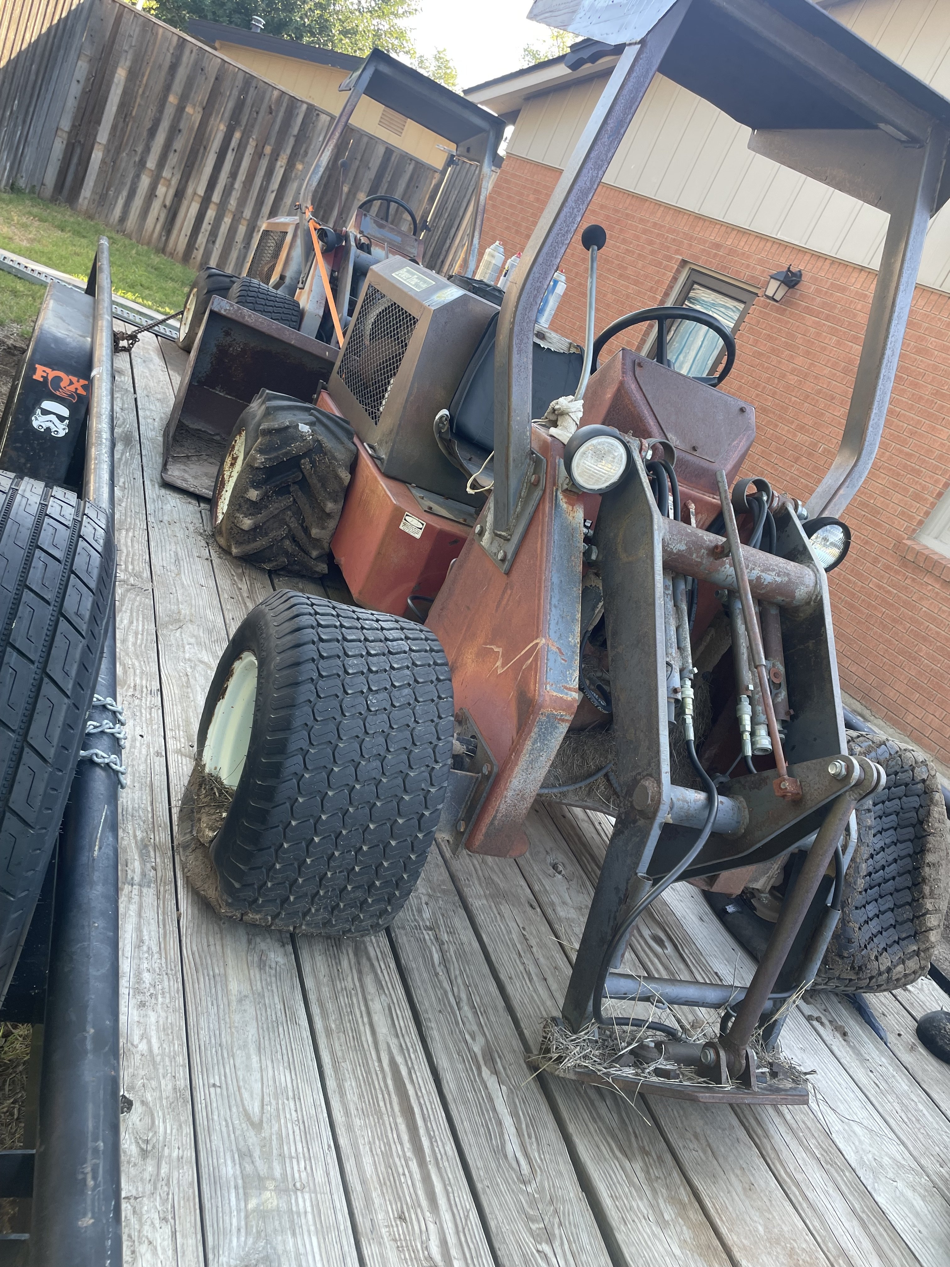

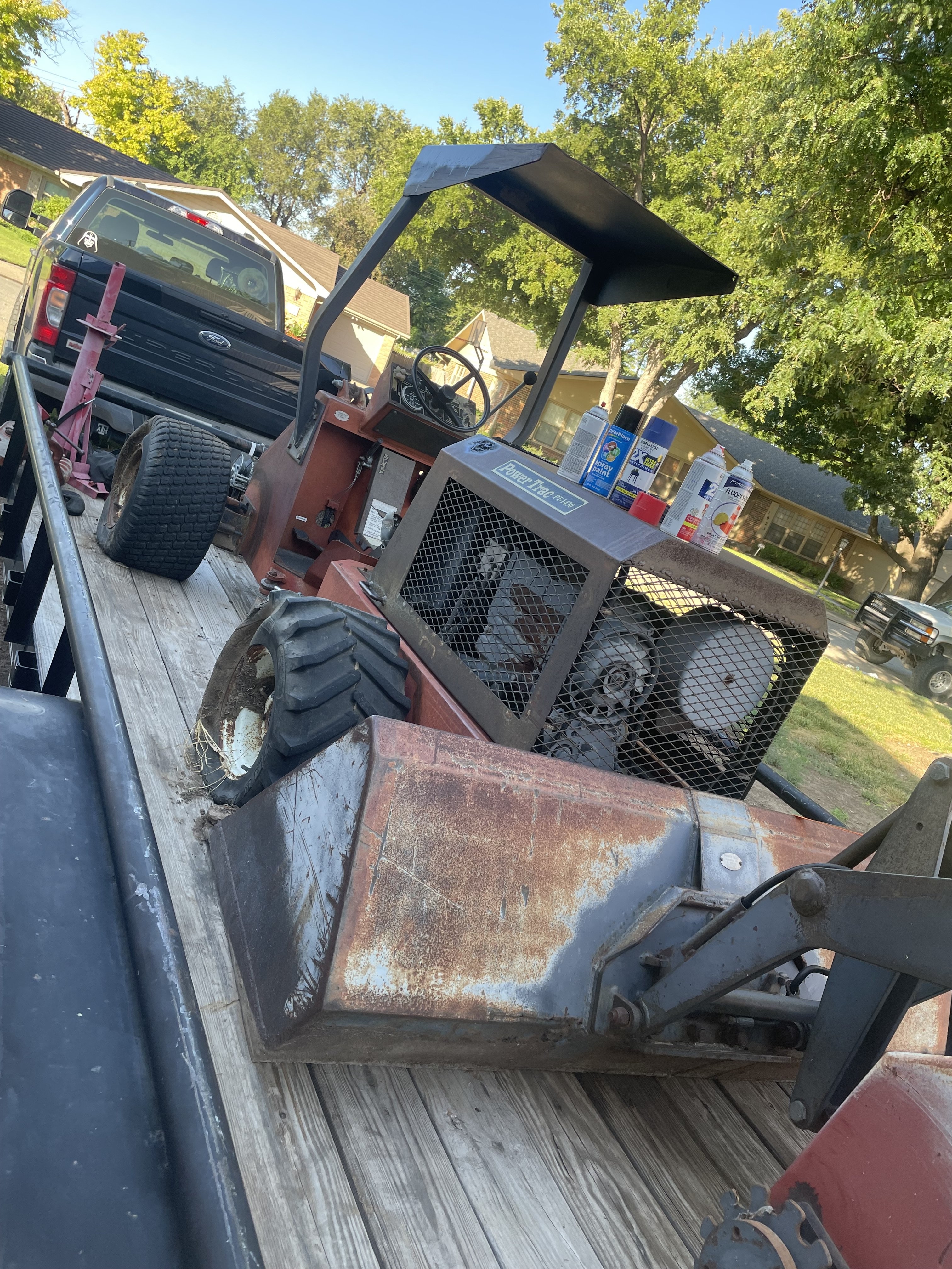

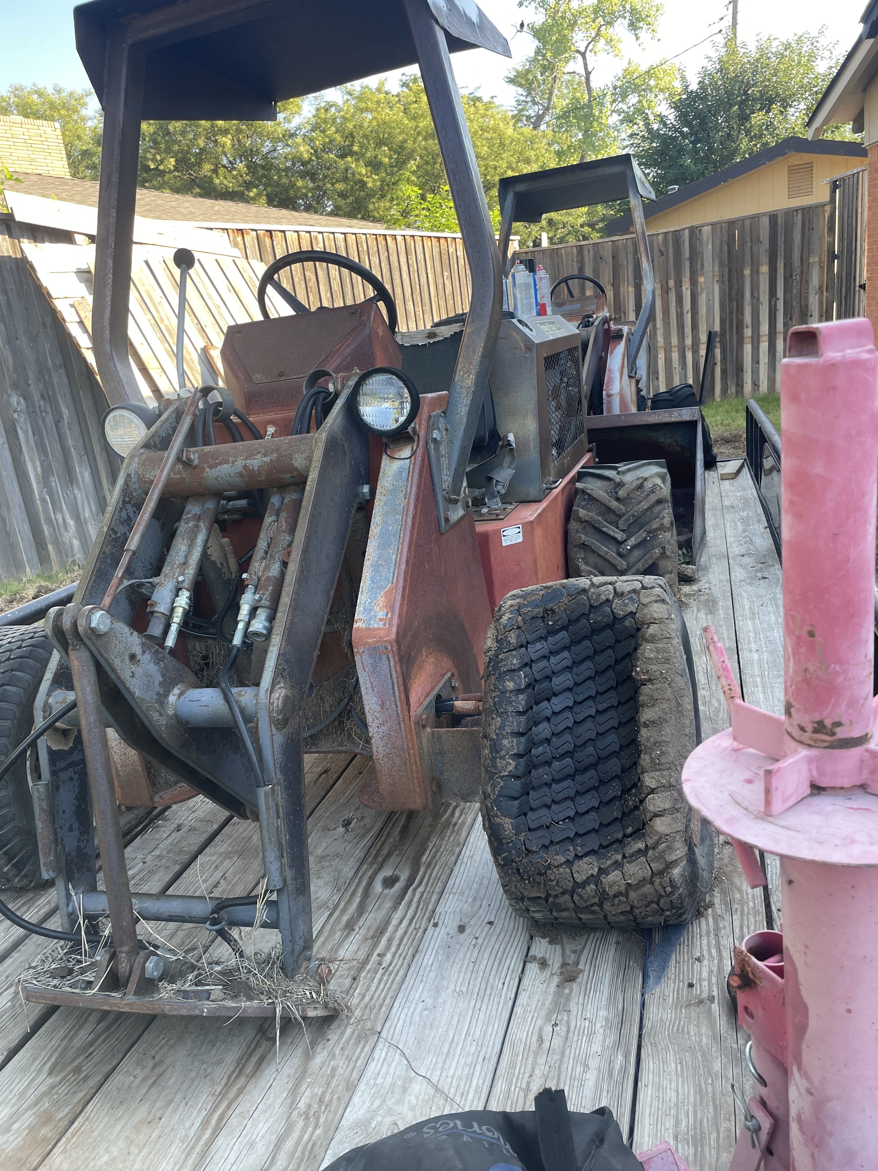

They need work but this is gonna be fun.

Well they are new enough to have the quick attach. The next improvement that I like is the hydraulic tram vs the old cable. If you have the cable make double sure it is in good condition as there is no brakes. The treadle pedal is your only control to stop the machine.
/ 1430 new owner Tx #14
@Poppy7094 great save! If the Deutz's move freely by hand, thanks a really good sign.
Do you know the backstory? Was it a municipality that had a couple?
