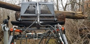

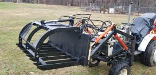

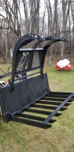

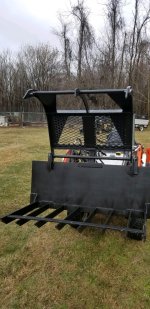

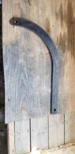

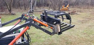

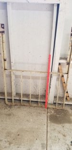

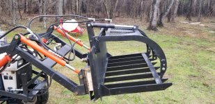

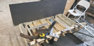

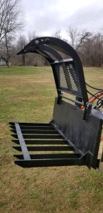

I started with the forklift backstop that had for about 5 years. I found the thumb metal in a used tractor yard. They gave them to me for free. The cylinder is from Surplus Center. The most money was spent on the quick attach plate, $78. I already had the hoses but I spent $10 on fittings at a local hydraulics repair shop. I had fun building it and works great.
Specs:

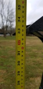

219 pounds
33 opening
40 wide at the base
28 thumb
25 deep
I built it handle and move fallen trees and brush on my property. That same week I added the quick attach and a tooth bar to the tractor.

I like it! I already have a new 3/8" thick quick attach plate, some steel but would need to buy the tines.
Then of course there is the matter of the third function remote...lol
The only thing I would add on yours is some more triangle pieces, one for each tine and maybe a bit taller and rounded if you have the capability to round them (torch or plasma cutter)
Thanks for sharing
   / $130 Subcompact grapple project
i plan to add more gussets in the spring. But for now, I have other projects to complete before spring. I do not have a plasma cutting so finding the tines was a lucky break.
