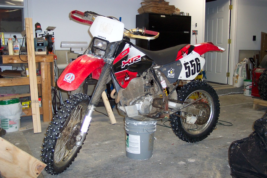

Back in the 80's I used to ice race motorcycles. We would take trials tires and put sheet metal drive screws in them just like you did. Gave great traction going sideways!
You only need 5/8" screws - no chance of punching through on a tractor tire.
Make sure to use the pointy-tipped screws (zip screws). Self tappers with fall out.
