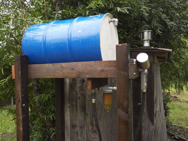

The $59 pump looks cheaply made and probably won't last. TSC sells a quality pump/nozzle/hose for about $250, currently on sale for $220. I chose instead to build a gravity fed fueling station with a $10 surplus 55 gallon drum. A second drum goes to town for refilling, and then is lifted with FEL attached forks on the tractor, high enough to gravity feed the drum on the stand. The nozzle, hose and fuel filter/water separator were all purchased at TSC for about $100. This set-up allows easy fueling of the tractor, RTV, and my truck. In the shed is a 10kw Kubota genset, which is currently powering everything on the ranch, as last night's severe windstorm created a widespread power outage. It could be some time before power is restored. 55 gallons will run the generator nonstop for over 4 days.
