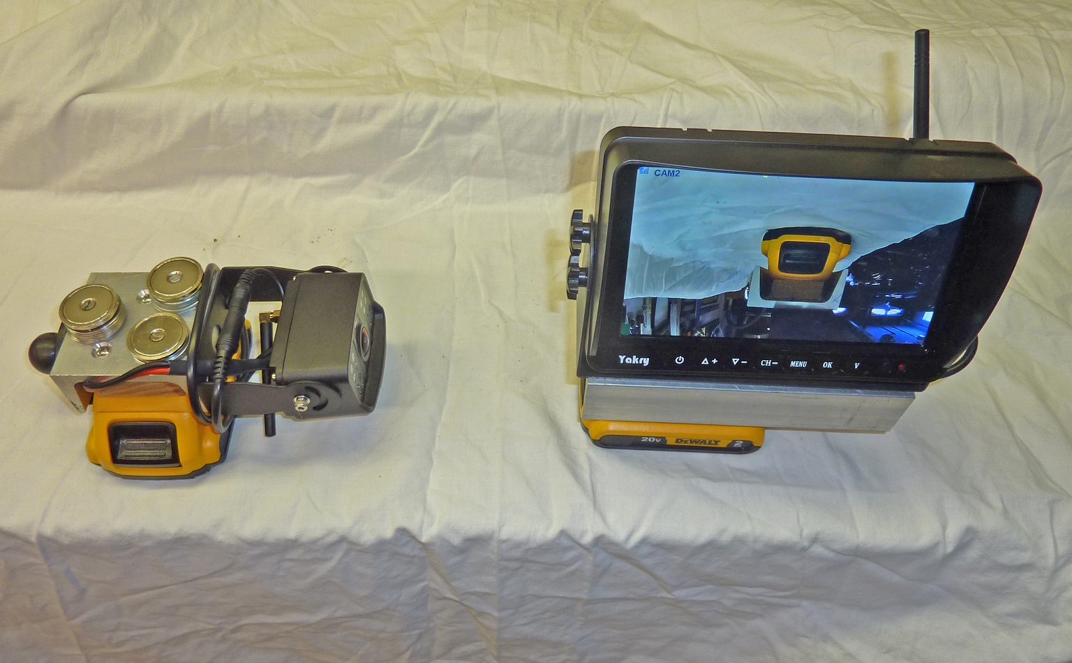

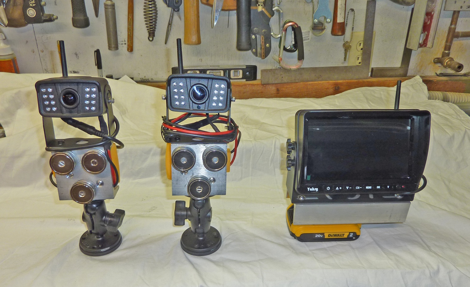

Since I have several uses for a camera system and don't need it all the time on any particular vehicle, I made this truly portable wireless camera system powered by cordless tool batteries.
The cameras & monitor attach with magnets to any metal surface.
Portable Tractor Camera System
