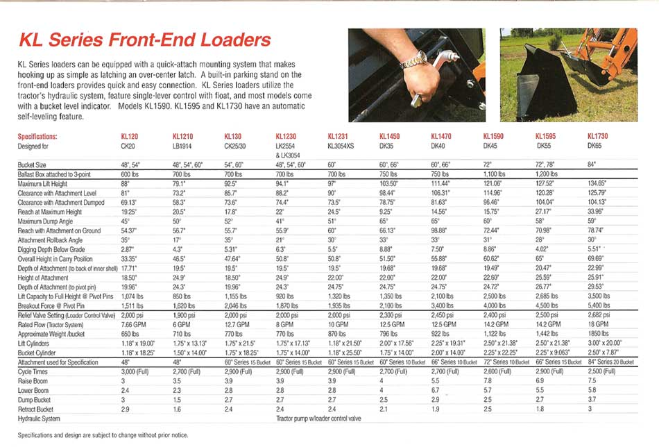

Does anyone know where I can find the specs on the 1231 loader? The Kioti site gives the same specs as the 1230 which I believe is an error.

Here's a scan from Kioti's implement & attachment guide

Bucket Size: 60"
Max. Lift Height: 97"
Clearance with bucket dumped: 73.5"
Reach at max. height: 24.5"
Max. dump angle: 51 degrees
Rollback angle: 30 degrees
Digging depth below grade: 5.5"
Lift capacity to full height at pivot pins: 1,320lbs
Breakout force at pivot pins: 1,935lbs
Approx. weight w/bucket: 870lbs
Hope this helps, this is a stout little loader for a 30hp machine.

Thank you so much gentlemen, that is exactly what I was looking for! It indeed is a stout little loader!
