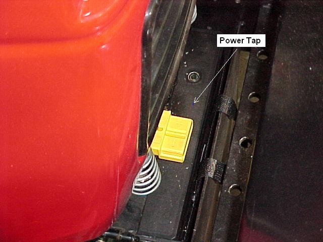

I recently installed a battery switch and accessory port on my tractor. It's breakered at 120 amps. In reality, it takes a bit more than 120 amps to trip a breaker of this size.
The battery switch allows me to completely disconnect all power to the tractor so that no electrical shorts can start a fire, etc. Also, it prevents youngsters from starting the tractor.
The accessory port allows me to plug in a charger or an inverter without opening the hood. I have a 2500 watt unit ($89 at Costco) which I NEVER use at it's rated capacity.
See that attached pictures

/ 12 Volt-110 Volt Power Inverters #15
See attached picture of the accessory port protuding from under the edge of the hood.

/ 12 Volt-110 Volt Power Inverters #16
Thanks Brad for defending my math. It's not the 20 amps AC that is the problem here. It is the 200+ amps needed from the tractor. Just sizing the wire for 200 amps will tell you that this is a big deal. My lincoln welder welds 1/2" plate in one pass with 230 amps, this is mucho current.
The last couple of pictures demonstrate the right way to install the 12 volt side of the system. You need a macho circuit breaker, macho wiring, and a macho connector, all rated for the high amperage you plan to use. I hope you have a good welding supply house for this heavy gauge equipment. Now if you really only intend to use a small part of what the inverter can produce then the 12 volt side can be limited with a smaller fuse at the battery and then the whole system can be downsized.
I really like the way the disconnect is wired in there. Great idea.
This is not unlike wiring in a winch to a pickup truck. In fact, the wiring can serve dual duty if you want to use it for one of those receiver hitch mounted winches. Also the connectors can be utilized to jump start your tractor if the battery ever dies from the inverter use. Might not be a bad upgrade after all.
Just don't make the mistake of underestimating the current required from the battery and realize that you can burn up the wires/tractor without appropriate fuses.
