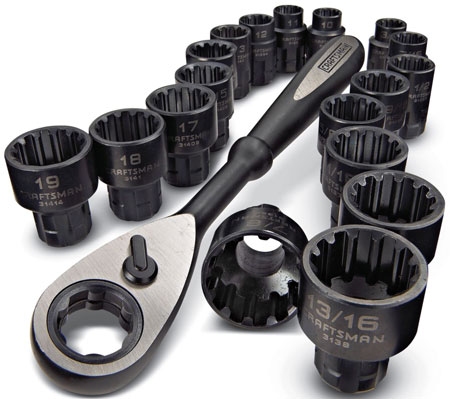

I like the 6 point sockets but the newer designs are moving to a new design that doesn't touch the points of the nut/ bolt. Here's a pic of Craftsman sockets.
Even their 6 point sockets have extra material removed to avoid putting force on the points of the nut/ bolt.
If these become the new norm then I don't know if 6 point will be of much use.

SNAP-ON has had this for years. They call it "flank drive". Maybe their patent ran out or they licensed it to other sellers.

SO's patent has been out for a Long time....every brand of socket uses this idea now.

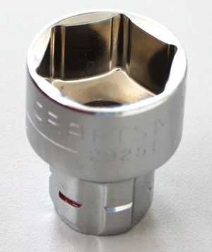

They are not new, Snap On had the original idea and patent in the 1960's.....it has since expired and as far as I know every socket and box end wrench made today uses some variant of it for at least the past 20+ years. Here's apic I found of one of the many names/trademarks that companies use now. Basicallly the idea is to contact the flats of a bolt as opposed ot the corners to avoid rounding out the fasteners. If your socket has rounded corners on the inside, they utilize this idea...

AS if to not confuse people enough, SO also has what's called "Flank Drive Plus" on some of their open ends..ridges cut to provide grip..and it is truely amazing at gripping nuts and bolts. There are some things from SO that are worth the somtimes crazy extra money, and this is one IMHO! Other tool makers have thier own versions, but SO is the best I have tried so far.
