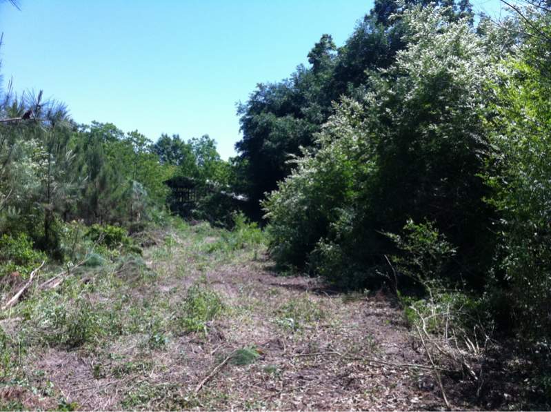

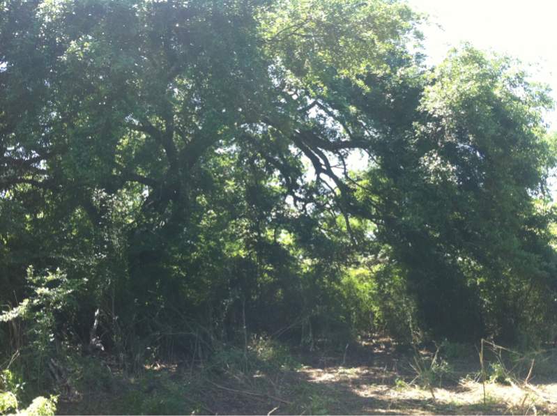

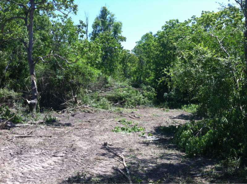

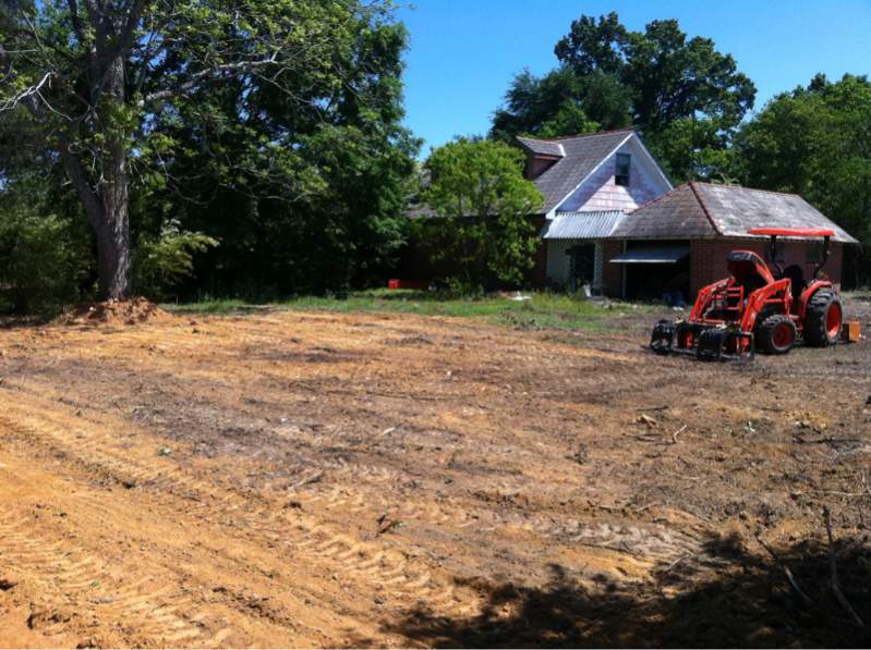

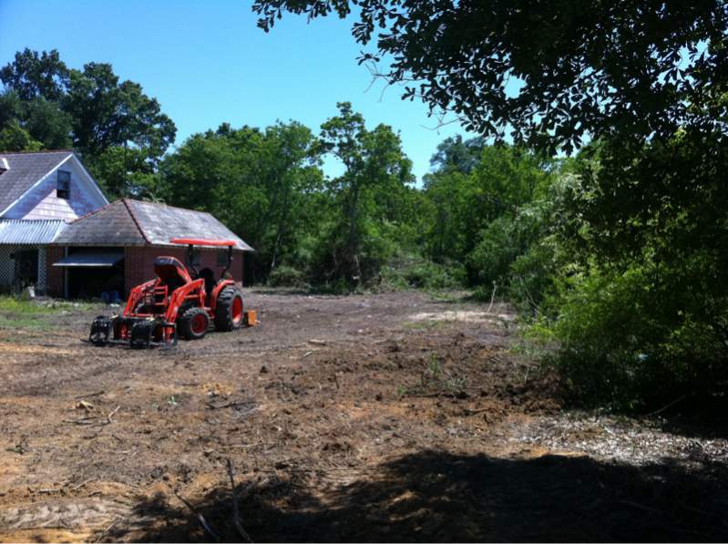

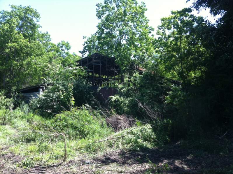

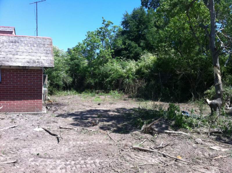

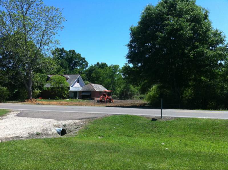

Here are some updates from recent work. As you might remember you could not even see the house from across the street before 3 weeks ago. I'm learning that slow and steady will win this race, when I get in a hurry things go bad.... It's not a dozer.
