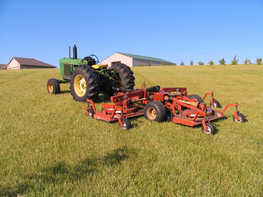

I've got a 13'6" Rhino mower that made my 1020 overheat on my hill. Its 35 pto hp. I think 1020's are around 3800 lbs but I haven't felt I needed more weight. Power isn't a problem now that I'm getting my 3020 utility broke in with it!
Tim

Tim,
Welcome to TBN!
A 1020 weighs in about 4800 lbs without ballast or weights and is about 38 to 40 hp. So it would compare closer to a 5000 series tractor handling implements, horsepower not withstanding. Compare the `1020 to the current 4320 for hp purposes.
The 1020 and 3020 are a great pair of tractors to have I have had 820, 3020 and 4020 all were very good.
Steve

Thanks Steve,
I dug out my 1020 manual and it is heavier than I thought, but the horsepower is 38 at 2500 rpm, less at 2100 which is the 540 pto speed. It should be able to handle the mower w/o overheating but maybe 42 years of use has something to do with it.
Tim
