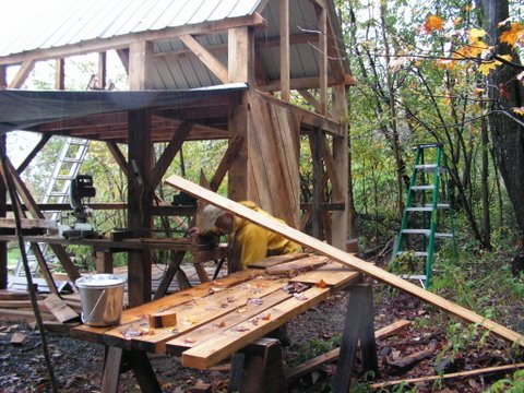

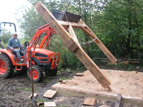

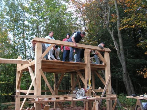

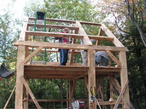

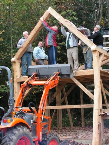

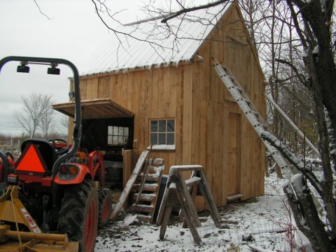

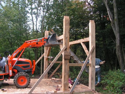

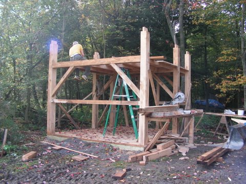

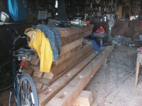

This was my summer project - cut hemlock logs from the woodlot - sawed with a friends band saw - did most of mortise and tenon work in the garage - wife and I raised the 3 bents and joists - had a mini-barn raising to put 6x7 inch rafters and main 6"x6"x12ft timbers along with dovetailed purlins. Siding is 1 inch rough cut hemlock boards - first layer diagonal - second is vertical.

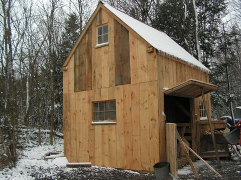

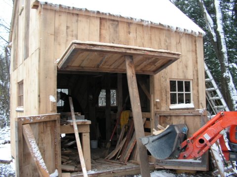

These photos show more of the construction. The entire building is mortise and tenon and pinned with 1" hardwood pegs, rafter purlins are dovetailed. The first floor is to house a few ewes(and hopefully 4 to 6 lambs come March) the second floor is for some hay storage. The doors in the last few photos allow access for the loader to do the cleaning. And at the end are Lucy, Stella (registered Katahdin hair sheep) and lambs Peanut, Minny and Moe (twins from last Spring) Actually just moved Lucy, Stella and Minny to new barn (hopefully bred) and now separated from WoJo the Ram.

Just curious. What mechanism are you going to use to lift the overhead portion of the door? It looks heavy.

The upper door is about 2.5 x 6 ft and so far is raised by hand. The plan for next summer is a framework along that side of the building to support about 4 ft of metal roofing. (like an awning) I plan a counter weight on a couple pulleys supported by this frame to make it an easier lift. For much of the summer and when cleaning the barn that door will be open.

Another question out of curiosity. Is the door style you are using "traditional" in your area (Upstate NY)? I am just speculating in my own mind on its advantages.

How did you do the foundation/floor and connections at the base of the posts?

I designed the door that way so it could be left open for light and ventilation whenever the weather is decent. The only time the bottom doors will be open is when I clean the barn. It seemed like a better way than to have two separate doors with side hinges. I could have had it swing into the barn (easier in some ways) but chose to swing out for shade and to keep the rain out. It's not necessarily traditional to the area as far as I know.
The foundation is treated 6x6 timbers for the perimeter with one tie beam at the middle bent. They are mortised and the six main 6x8 posts are also mortise and tenon into the base. The floor is 2" hemlock planks nailed to the foundation timbers. The foundation 6x6s were set in the ground a few inches and crushed stone was filled to grade. The building is at the edge of our woodlot so is somewhat protected. It actually just sits like many little buildings but I predict it weighs many times that of most. Most buildings of this sort have a single layer of boards for siding - often board and batten. This building has 2 layers - the first is diagonal which really stiffens the building - then a layer of roofing felt to seal - the finish layer is vertical. Kind of overkill but with my own lumber the main cost is my labor (and I'm not worth too much anymore)
