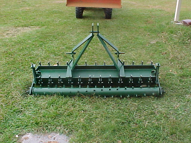

Finished building my pulverizer and thought I would try to post some pics. I bought the 10" I beam and the "A" frame and a few steel pieces. I think the only thing I would do different is try to weld a little better. I began to get real good with the grinder tho.
I really enjoy this forum with all of its great ideas. Thanks to all for ideas and help. Billy

Looks great .. quite a bit of welding you've done...scozz

That is a really slick looking job - but I have a question. What exactly is a pulverizer for? This is sort of a newbie question but I am asking because sometime next year or the summer after I will finally get to the point where I can finish off the landscaping on my house and I am wondering if this is an implement that could do me some good. I've got a welder and am always looking for a good winter project. Thanks

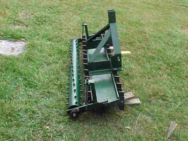

another pic

Jim I'm fairly new to this tractor thing but I do a little new home construction landscaping here in SC. Most of the lots are 1/3 to 1/2 acre. We usually till, boxblade to move dirt, and finish off with either the boxblade set way back so you are working with just the rear blade to get a smooth job or use a pulverizer. Sometimes you can get by with just a pulverizer if there is not too much growth. Anyway the roller on a pulverizer gives the yard a SUPER smooth and flat finish
that is unmatched with a boxblade. I know there are lots of people on this site who are very knowledgeable on this subject
but this method seems to work in this part on the state.

Bill thanks for the comments. I don't think I'll be in Texas any time soon- tho I sure would like to be. I have about 20 or so hours in this thing but I really don't have a real good drill press (for 25 pairs of holes) plus all the other holes. Also this thing gets pretty heavy real quick. I had to use the Kubota to lift and move around because my shop is kind of small. All in all it's a simple piece of equipment and I'm sure you would have no problem in making one.

Ok, I can see this thing has uses even without the front part.......which could be a rake or anything else 3 pt. I want to know how you made the roller and pins.

I got a pipe 5" dia. by 5'-6" and had a friend with a plasma torch cut the end plates out of 3/8" plate. He also cut a hole in the center 1" dia. for the 1" steel rod which goes all the way trhough. I tacked welded the end plates on with the 1" rod and trued the rotation similar to using a lathe.Once the roller ran true I finished welding the end caps and the 1" rod.
The spikes are 3/4" pieces of a 10' ground rod. Each piece is 1 1/2 " long welded to the roller. The ground rod is copper coated steel which should hold up pretty good.

Mad-- I looked at several pulverizers on the net and some sites even break down a parts list and how they are assembled. Also I went to a local Agri Supply and looked at one first hand. Theirs was a little different- not as heavy duty as some other models. A pulverizer similar to the one I built sells for around $1000. Not much in material but a lot of time.
