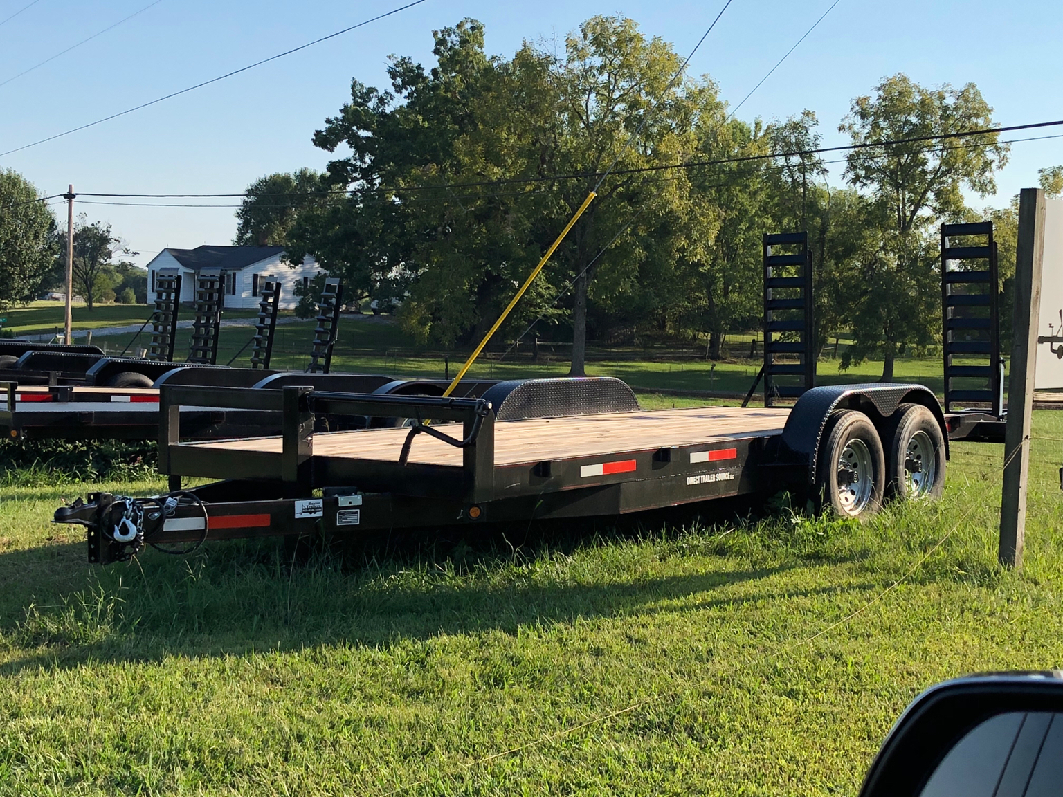

I never heard of Gator or DTS but for me, I like powder coating provided it is applied right. Many trailer guys would rather have just spray painted covering. I would get the spray coated trailer and hope for the best.

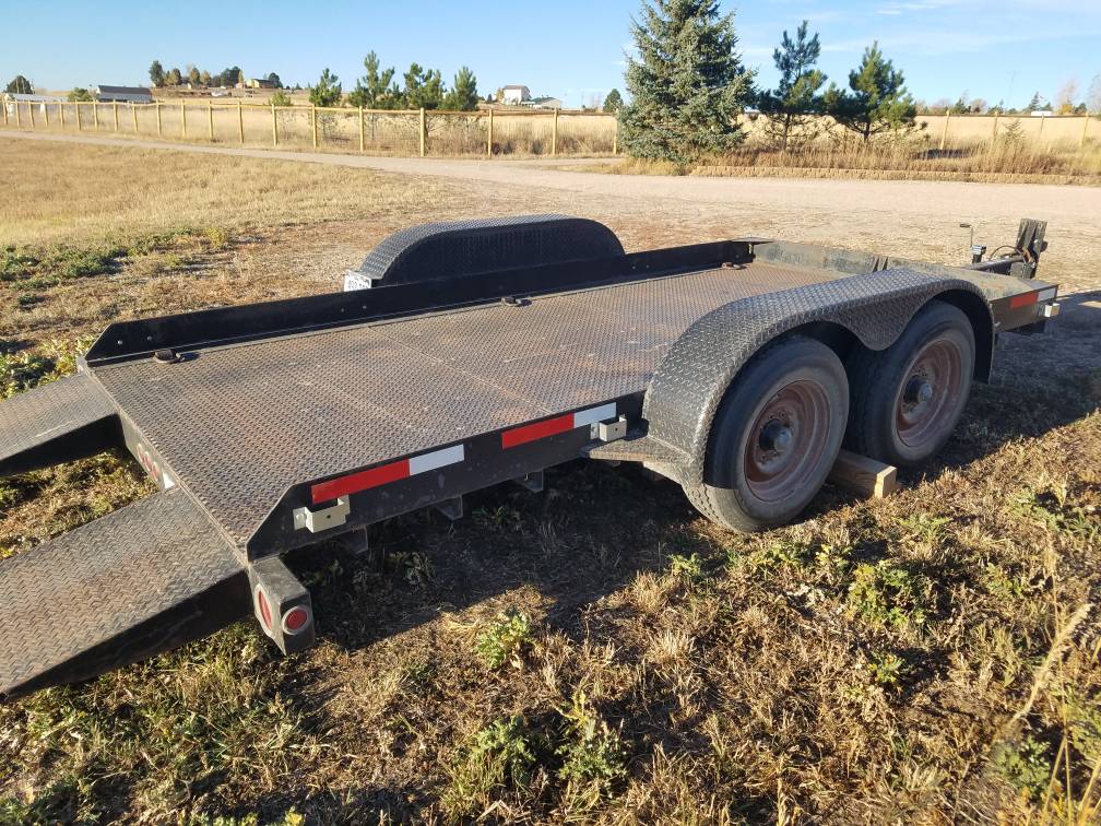

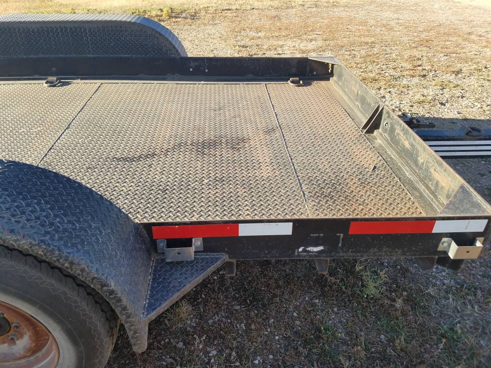

My old tilting deck had a 4" tall lip around the front & sides of the deck. I detested it. Tilting decks already aren't great for side loading anything due to the fenders. That lip prevented you from getting anything on or off with pallet forks unless you stacked another palet underneath.
Trailer was good for an auction score. Got rid of it as it was to short. The rim around the deck always irked me though. Handy when I temporarily made it a stake side for some manure hauling , but otherwise in the way.20161031_082657-1.jpeg20161031_082712-1.jpeg
