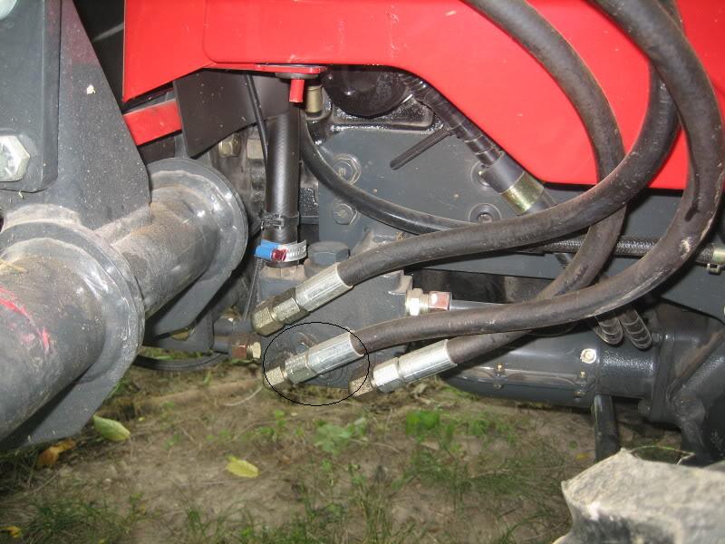

so I guess thats about right, 600lbs of railroad ties and 150lbs of forks pretty much sums it up. It still beats the **** out of manual labor ! If I may add, attached is pic with some sort of hydraulic box. In the lower center there is a kinda selector lever that has two positions. A bolt holds it in place, what are the two positions for ??

That selector is used to change the hydraulic flow route. One position is without a loader and the other is with a loader.
