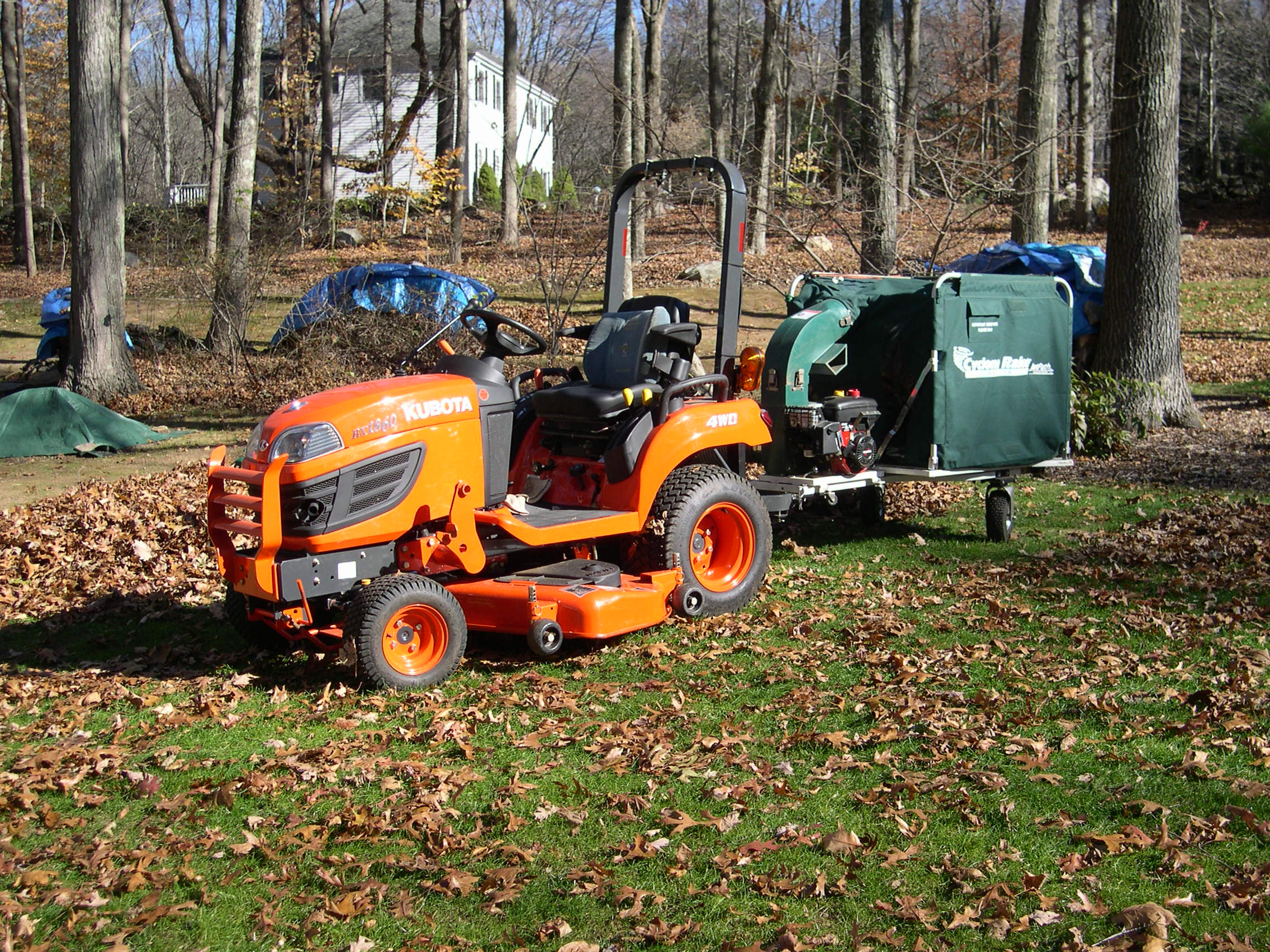

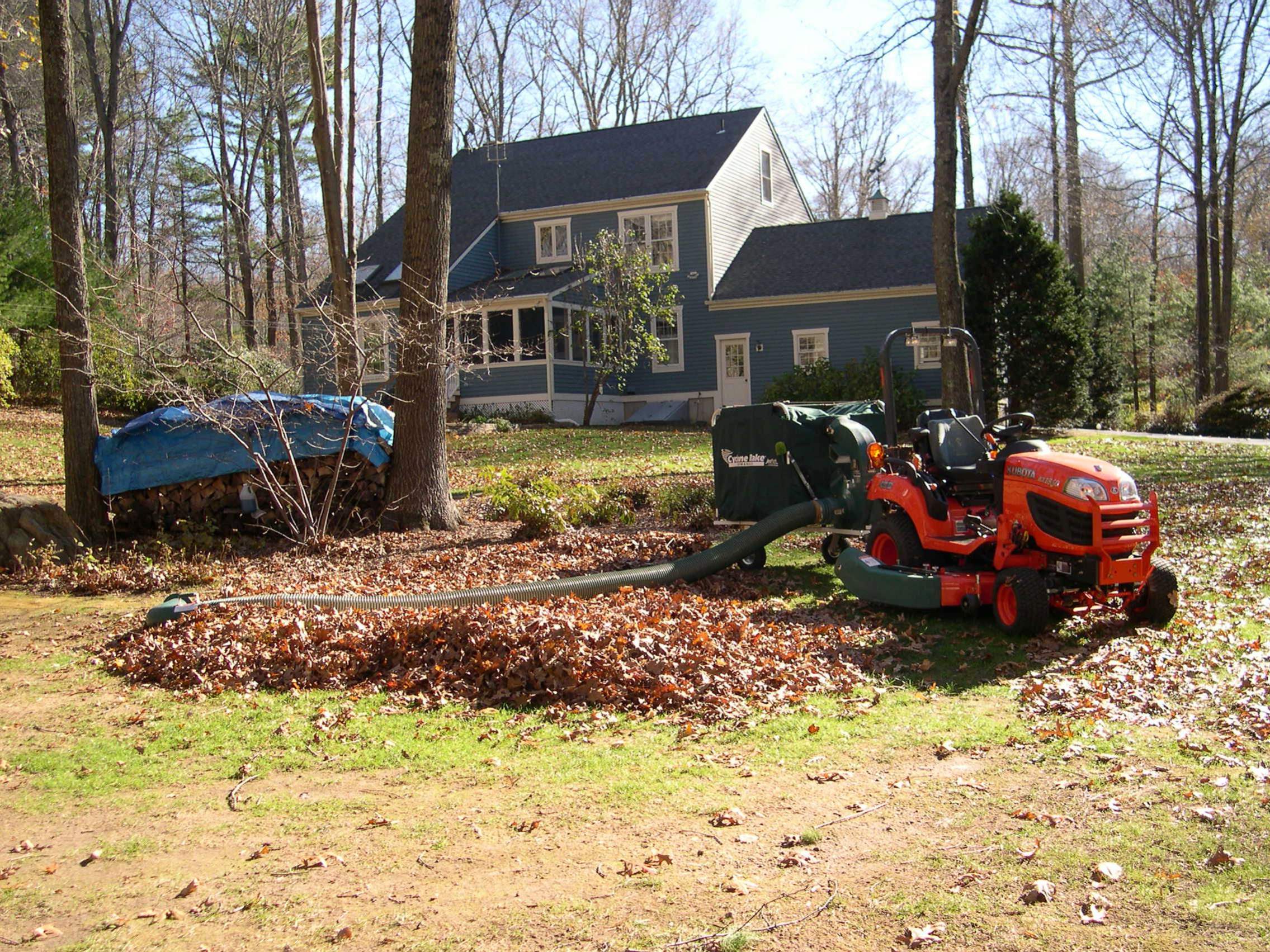

I assume you've ruled out a Cyclone Rake? It does have a 2 point hook up to the 3PH. No hydraulic dump, but I think it can easily be converted (which I might do once I add rear remotes (my current project)). Anyway, just in case you're not aware of them, here's a pic. They're made here in CT so I was able to see them at the factory before buying. Well made unit in my opinion.
By the way, beautiful piece of property you have there in MA, and welcome to TBN.
